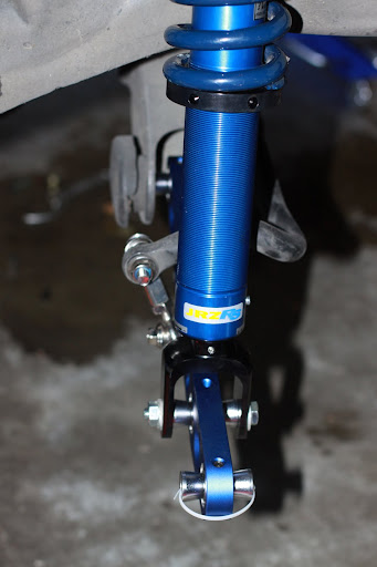

JRZ RS - new coilover I'm getting, with Eibach ERS springs and pillow mounts. Not sure on spring rate yet; I'll be doing some testing to figure that out with different rates.

The coilover decision was a big one. I was going to go Koni 3011's but Andrie from PRIMA RACING | Home Page suggested I look at the JRZ instead. A little more cost for a lot more performance; why not..

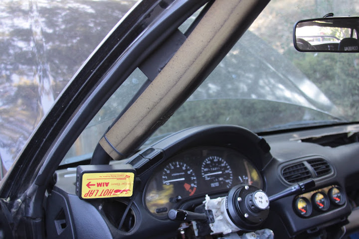

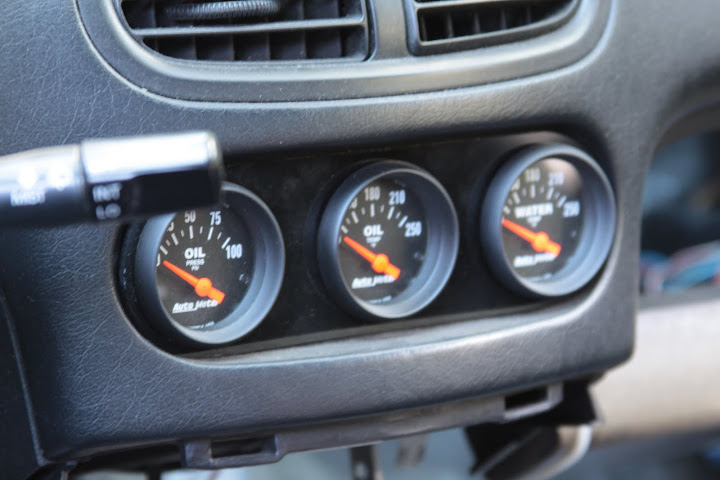

Nice guage mount I made.

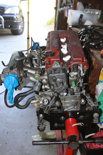

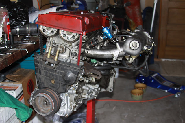

B16B pistons in B18C5 block.

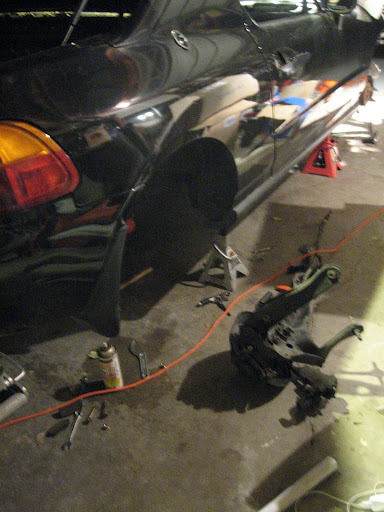

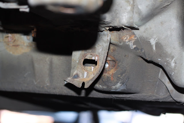

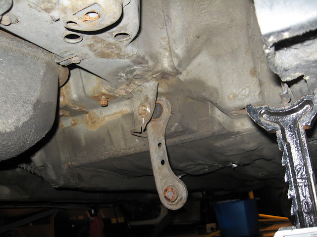

Rear trailing arm removed.. this took forever because of the compensator arm.
Bastard of a compensating arm. I need to cut this out now that I got it to back out some.. Frozen to the bushing.

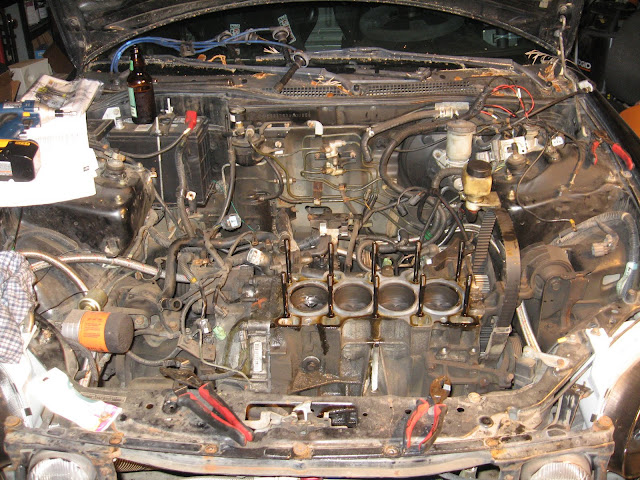

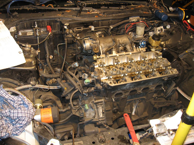

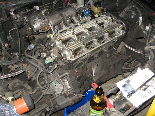

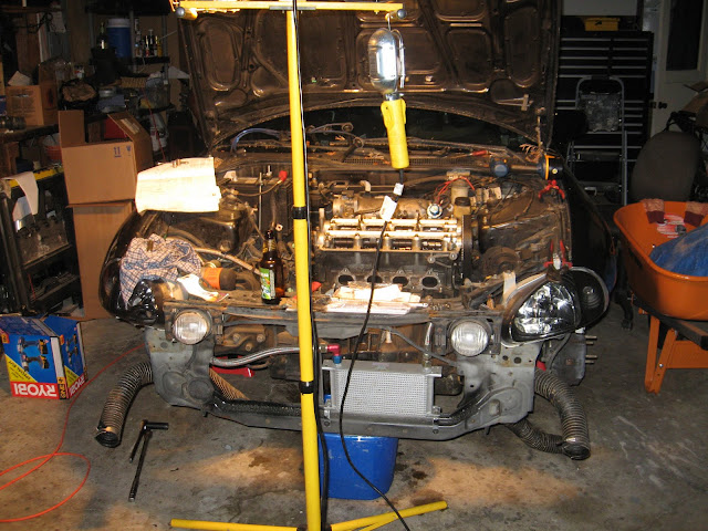

Getting ready to pull the head for head work.

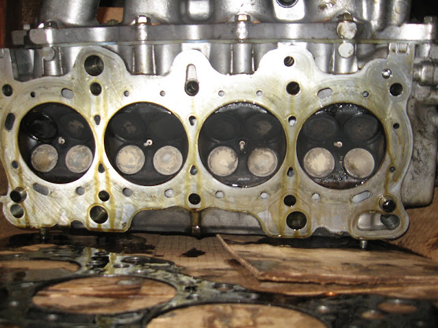

Notice the white shit on the heads of the bolts in the oil; condensation/water. I think this is from my catch can that vents to atmosphere with no filter. Suggestions??
Cams out, everything disconnected..
No head.
Is this ok for the exhaust valves?

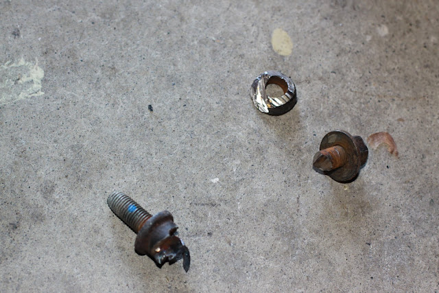

Cut that compensting arm out finally:
The bolt aftermath...

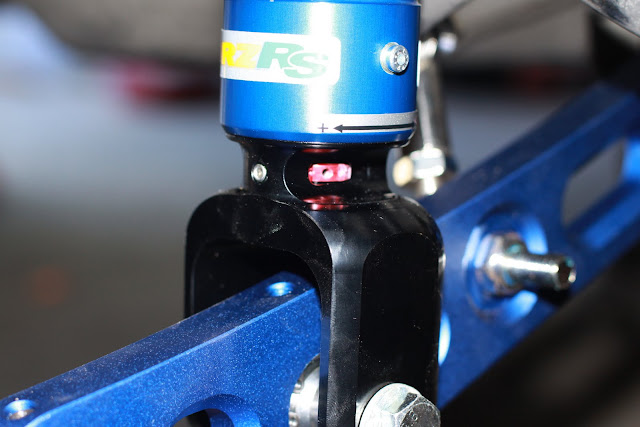

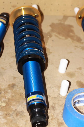

Double adjustable JRZ RS with modified Tien top hats.
Rebound adjustment on the bottom:

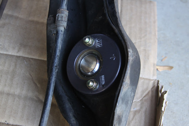

Installed with new LCA with sphericals.
Another angle. Looks like I need to space out the end link so it is not at such an agressive angle.
Rebound adjustment for the rear's

I got the engine almost completely complete! Checked P2V clearances and even at full range on the cam gears there was no contact with the piston with vtec lobes engaged. Also got my rear trailing arm sphericals installed.

I discovered my RTA bushing was totally shot; so I ordered the PCI spherical. While I was at it decided to go spherical for the front LCA's as well. Will post pics later!

I think my catchcan was allowing moisture into the engine. Note the pic with the valve cover removed; you can see white shit on top of the cam cap bolts. My catch can had no filter on it and I noticed the lines from the valve cover breather to the catch can was clogged with white shit like it was an artery of a 500lb man.
I'm giving the head to my buddy to check out; install new springs/retainers and valve stem seals. Engine and tranny get pulled next so I can remove my ATS LSD and install my new KAAZ.

JRZ's are here! Damn they look nice. In the process of modifying the Tien spherical top hats to accept the dampers which should be done next week. Starting off with spring rates 800 front 900 rear. I'll take some pics tonight of the dampers.
Also picked up my spherical rear lca's.
