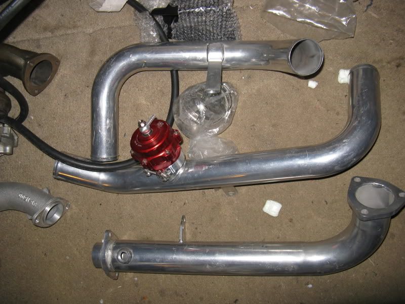

Next phase for the summer is the turbo kit once the engine gets about 8-10K kilometers.

thinking of slapping these for my summer wheels

it is still a long way to be finished. I still have the turbo kit to install but that will be in spring.
here are some teaser pics of my turbo kit.

look at the baby turbo, its so cute lol. jk, i'm just so used to seein my friends turbo on his 2jz. wish i had a coke can next to it to compare size lol. It's a pte71mm/.68ar w/ 4 inch inlet and anti-surge housing.
Great job so far man. getting a lot of work done awfully damn quick
