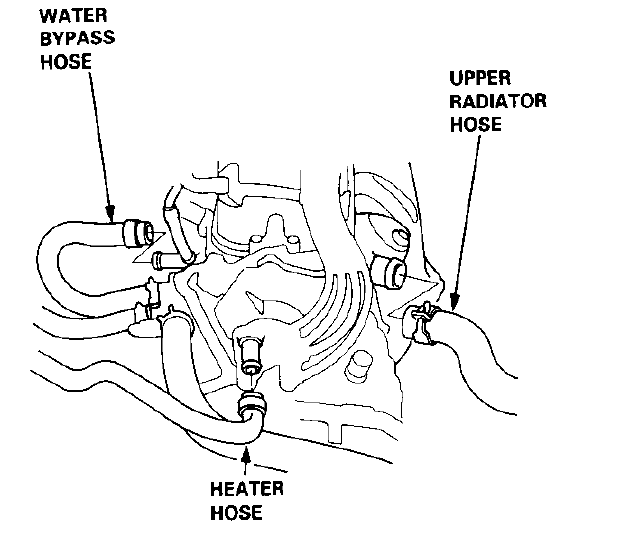

sweet ya. fuel injection air is what it's called. now i gotcha. the honda manual covers that for 2 whole pages and never otherwise mentions it's existance (even in the cooling chapter, because the valve is actuated by engine coolant temperature).
Well since the ECU doesn't control the operation of the FIA valve, that doesn't matter.
What does matter however, is the fact that the FIA valve mounts in the thermostat housing. So since your going to swap in a Y8 block, you'll have that valve in there.
May as well route the lines to it (one air line to the intake arm, the other to the intake manifold).

so if i run a 96 ecu can i just plug the holes on the intake manifold and be fine?

plug them up, see it if runs fine. I've seen a few swaps with that sitting there and kinda wondered why they were. The manuals i have cover nothing on it cause OBDII is just a PIA for me. I may be able to get a hold of someone i know around here with a 96+ Ex and check out that system.
People get after market manifolds all the time anyway, and the Y8's are supposed to flow the best out of all the stock ones. I'd say from that its safe to plug them up.
Heres one without it
I think it actually plugs to the intake arm looking at these 2 pics, but i really cannot tell.

z6: Ahhhhhhh. and yes, it goes into the intake arm.

Tell me if you think honda will get mad and sue for hosting this. If your that scared, I'll host it then. I just don't get enough upstream bandwidth....

image 1000017DJ6 is what your concerned with. the thermostat housing is on that side of the motor
it sure does appear that the block in the pictures you posted does not have that valve in it. just to be clear, this is a USDM motor? and that is the Y8 block, not your old one, right?
this is the best picture I have of it in my old motor. just to give you an idea....

you know... if you look close in my pics it looks like it might connect at something

maybe i'm still not clear. by your first post, i'm under the impression your taking w/e head you've possibly already found to be compatible with a Y8 block, and swapping that head onto the Y8 block w/ the Y8 intake mani. Am I right?
Old head
New used block
New used trans
New used intake mani?

doing the whole swap. new 2000 d16y8 motor with trans and cam
so everything is different

hmm I wonder why the intake mani has that port in it, but the thermostat housing doesnt seem to have the valve then.

i think it may be covered up by the hose. look in the pic from the left side of it.

O alrighty I see now. It could still be attached to the hose. Well let me know if this gives you any trouble when you fire it up. Best of luck!
YBLEGAL is offline   Reply With Quote
Old 06-10-2008, 02:58 AM   #48
Posts: 229
Default
so you think i should just let it be?

Yes.
