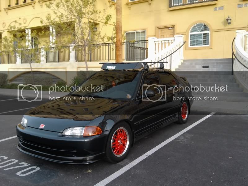

my dd, 95 sedan with 170k stock d15b7, may need a new tranny, looking for 200whp $1500 budget.
what are my options at this budget?
build the d15b7 and boost?
dohc zc and boost? how much do i have to build for boost?
b20 swap? not 200whp
i need to keep the build in my budget and also need to keep ac/ps.
any suggestions would help me choose my build. pros/cons, need some feedback.
my daily
