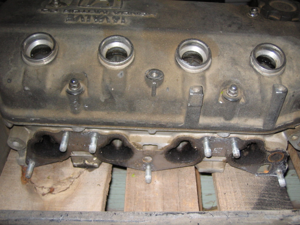

Oh how quickly plans can change!!!! I was out at the local pick-a-part today and came across a 1991 CRX that had a JDM ZC SOHC swap! Bingo! Pulled the Throttle body / Intake manifold, snagged the whole engine bay harness, and grabbed the dizzy, along with the PM6 ECU....
So, tomorrow I'm gonna go back and pull the head as well. I grabbed what I could, seeing as how these are the required parts to do the MPFI swap. Would have gotten the head but by the time I found the car I only had 30 minutes untill the yard closed. Didn't want to chance missing out on the parts I could get in the time I had. I'll post pics tomorrow or Saturday.

c-rex-beat; yes, it's a non Vtec head. Since emissions / smog checks are a real bitch here in So-Cal, I decided to stick with the A6 head. Draws less attention if some Highway Patrol Officer decides to pop the hood...
Checked out the Intake and Throttle body this morning; turns out the TB is stamped "JG Racing"
Looked them up and found this...
JGE Home
Turns out that if you send them your throttle body, from a ZC in this case, along with $135, they bore it out to the maximum diameter (59mm) and rework the internals too. So I'm super stoked now. Especially since the yard only charged me $50 for it... including the TPS.
So I made it back to the Pick-a-part today. Super excited... Pulled the head, got the complete head, along with the valve cover, cam gear, and timing belt cover. I also had enough time to get under the car and I managed to pull the entire rear trailing arm / disk brake assemblies, along with the factory rear sway bar!!!.... But that will be a discussion for another day, and another forum ( but I still might sneak a few pics of them, just cause I'm proud that I landed them )
I work in the morning Saturday, but I'll try and get pics taken and up once I get home tomorrow.
Thanks again for all of the input and ideas / suggestions. This is still a learning curve for me, but I'm having fun with it!

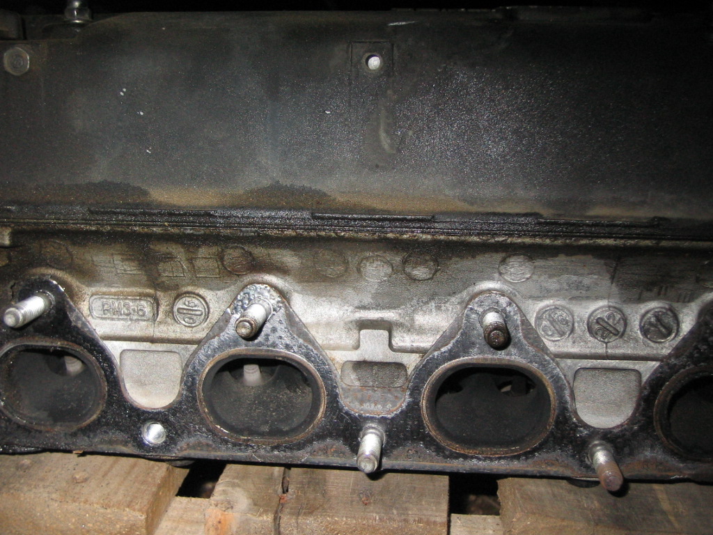

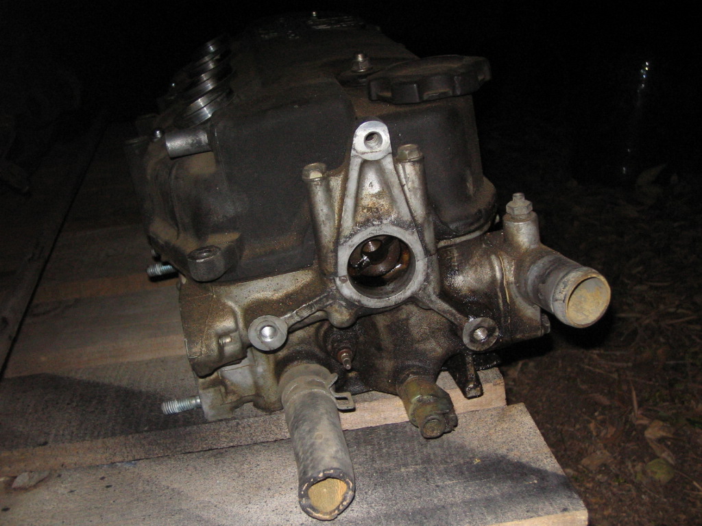

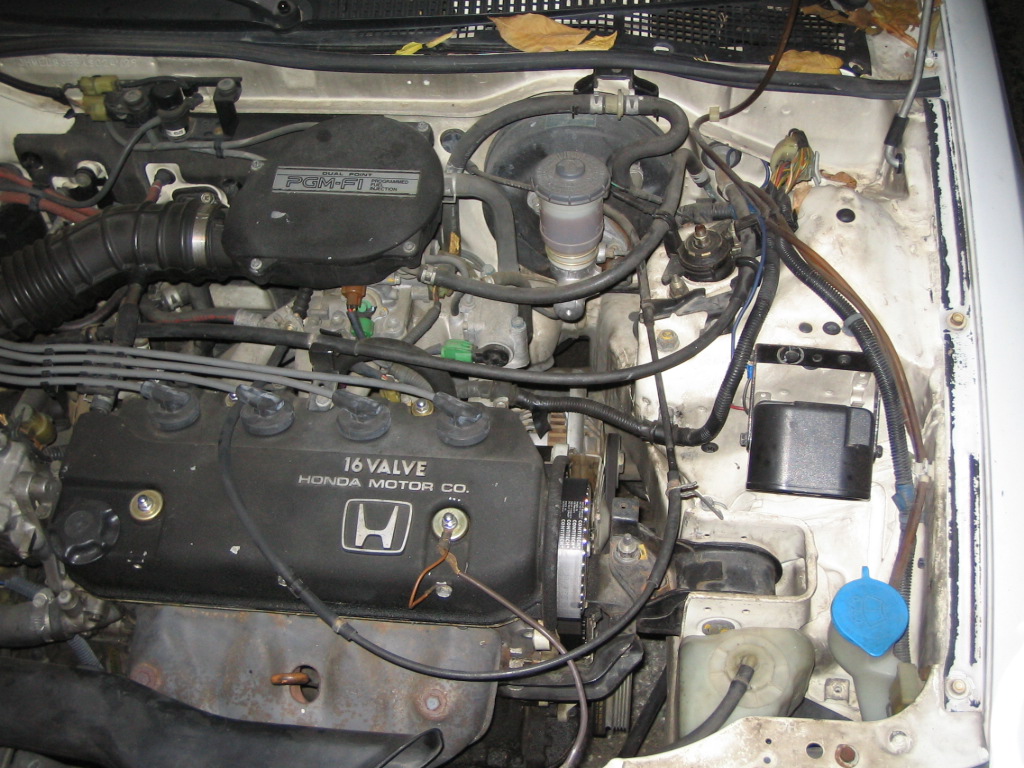

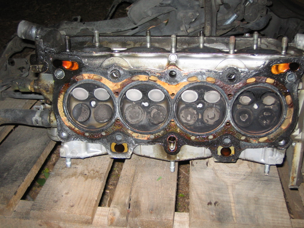

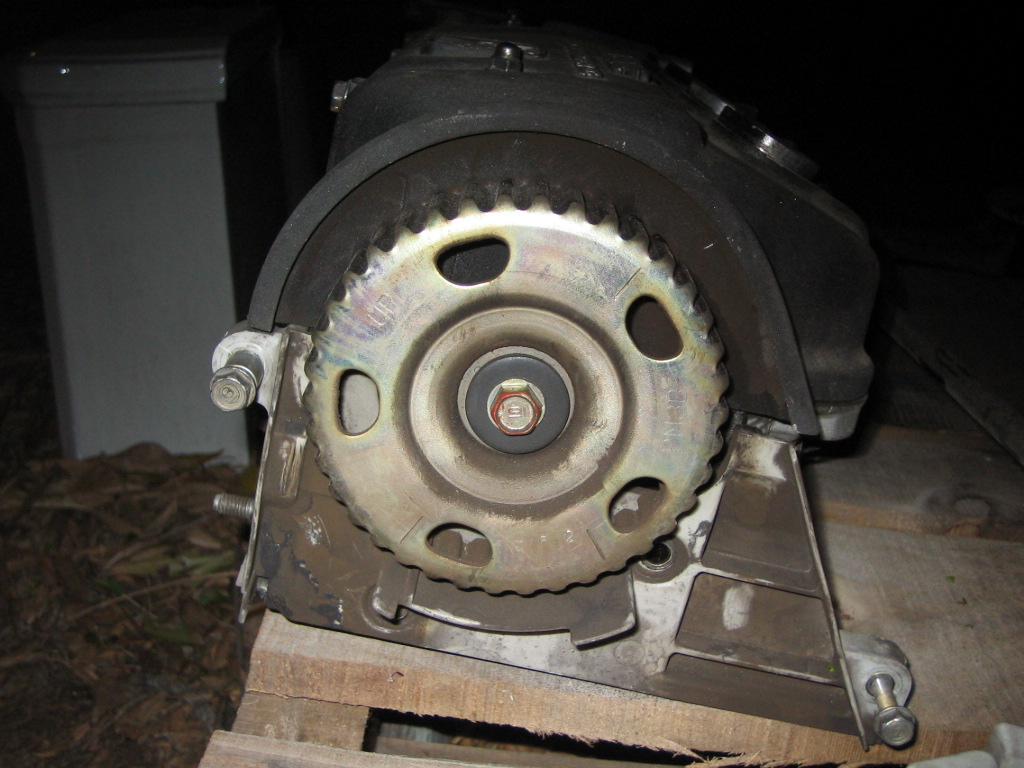

Made it home from work and got some pics taken, so here goes...
My 1989 DX Beater...
Engine bay is pretty much stock...
more...
http://www.norristech.com/CRX/CRX_006.JPG
http://www.norristech.com/CRX/CRX_007.JPG

So here are the parts I picked up on my days off this week. Can anyone help me ID this head??? I have looked at several head Identification lists on several forums but I have yet to see this actual designation "PM3-6"
Looks yummy!!! not.... Hopefully I can get the head out to the local shop sometime next week. While they have it apart, I'll get them to give me the #'s on the cam so I can ID it. More pics in the next post....

i think its just a basic non-vtec zc. i cant recall if the actual a6 head said pm3-6 or if it said pm-6..
What are you going to have the shop do to it?
