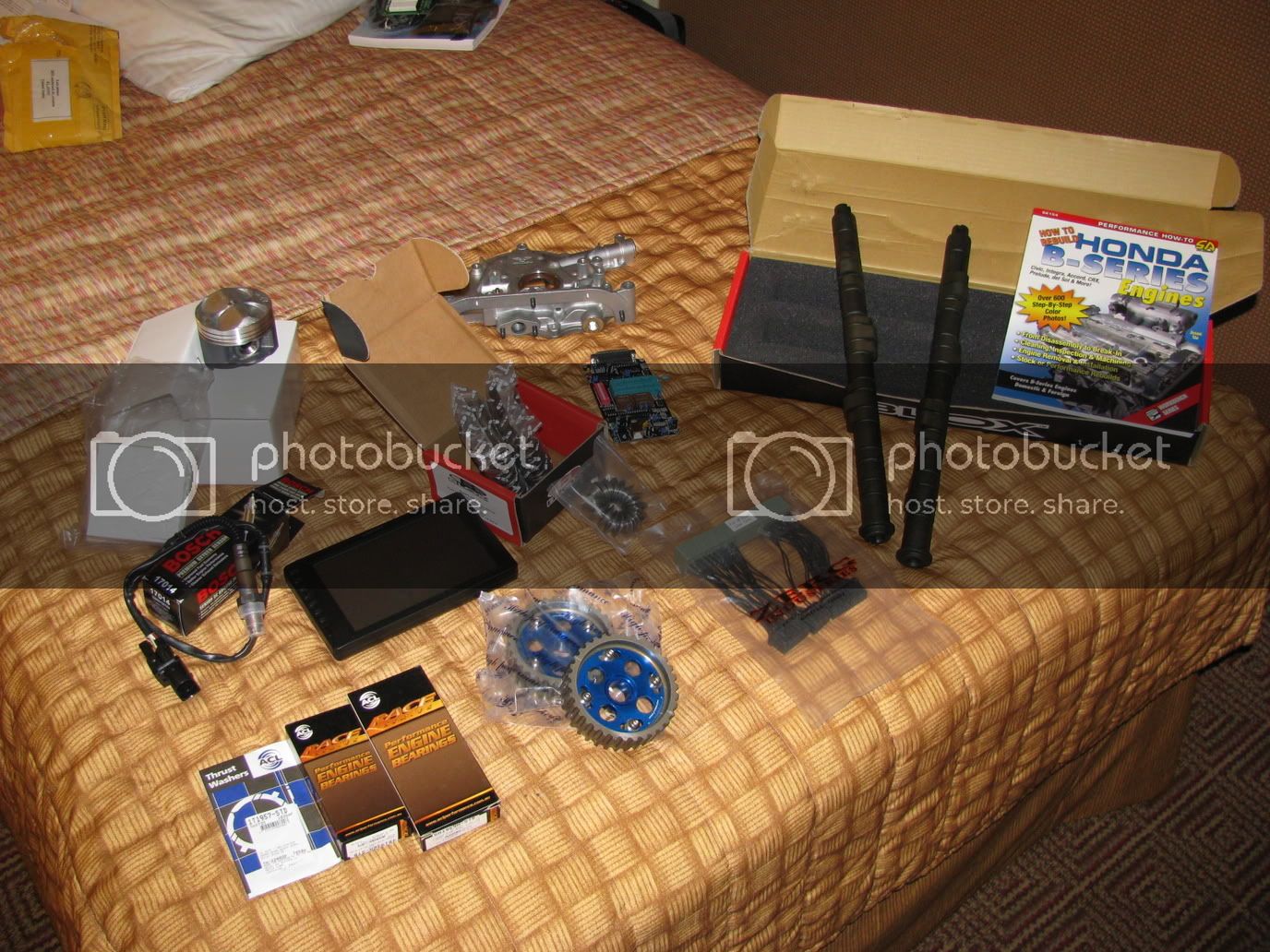

So what... We dont have any B18´s here, and a K swap still expensive.. SO i decided to make a quick B16a.... With a little more displacement. :funny:
Check it out:
Head
-Port polish
-BLOX Springs
-KMS Steel retainers
-BLOX tuner B spec cams
-Adjustable cam gears
-New guides and retainers
-OEM Head Gasket
-New OEM head bolts
Block
-EAGLE crank 84.7mm
-EAGLE H Beam Rods
-Custom Arias pistons 81.5mm 11.6 CR
-ARIAS OEM rings
-Bronzinas ACL race .25 over
-OEM Oil pump with mods
-New GMB water pump
-Block ARP studs
Intake

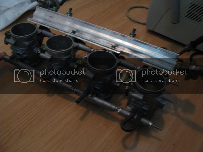

-Hayabusa ITB´s
-750cc Siemens injectors
-MSD Fuel pump 286lph in tank
Exhaust
-4x1 Inox header
-2,5" exhaust
Ignition
-MSD spark cables
-Iridium IX sparks
-MSD Blaster SS coil
-MSD dist. cover
-MSD Rotor
Drivetrain
-Displato clutch
-New transmission retainers
-OEM flywheel lightened 2kg
Tune
-Chipped P08
-EcTune
-Wideband 24/7
Others
-Light crank pulley
-Eristic gaskets
-Gates radiator hoses
-Energy bushings
-Fremax rotors
-EBC Yellow pads
-No AC

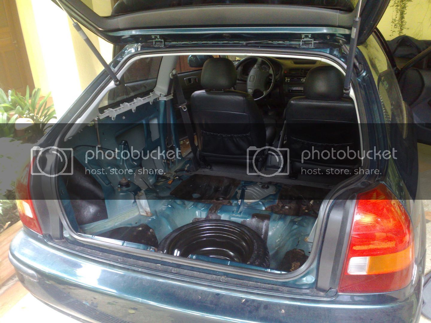

-No rear interior
-Gates t-belt
-4 point roll cage
-Dunlop direzza tires

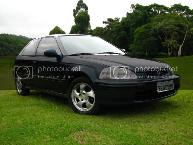

And there some random pics for you guys:
