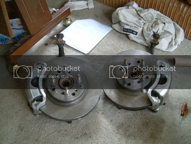

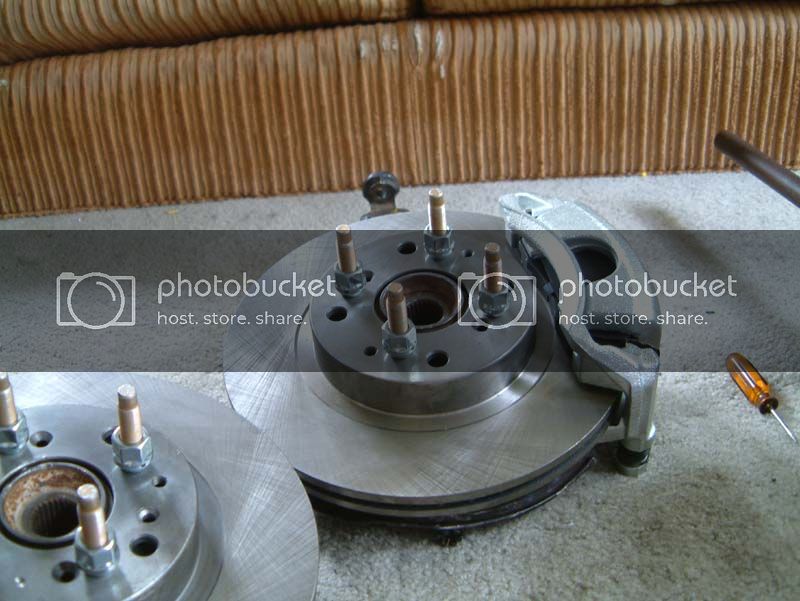

Here is a pic of the whole setup with new bearings, and extended wheel studs.

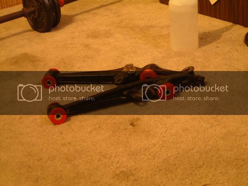

Front LCA with Poly Bushings
