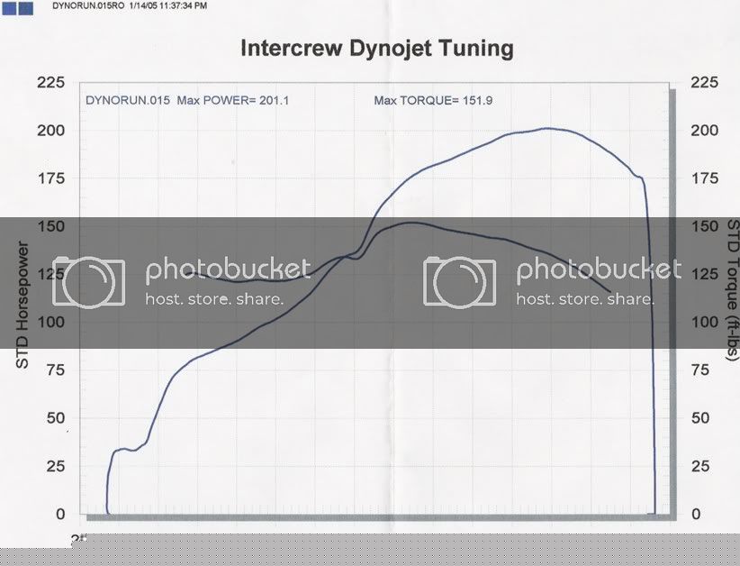

    back in the day Import Builders/Wiseco had a set of 13.5:1 pump gas pistons, made 201whp in a B20/vtec with S2S2 cams and a non-ported GSR head for me. I believe I was only running 750 injectors, not for sure though.
    1/14/05...old school like a mo'fucka! lol...
    I've still got the cam gear settings, too...+4* both intake and exhaust.
    I've still got one of those pistons sitting around somewhere. It's melted to the connecting rod :D

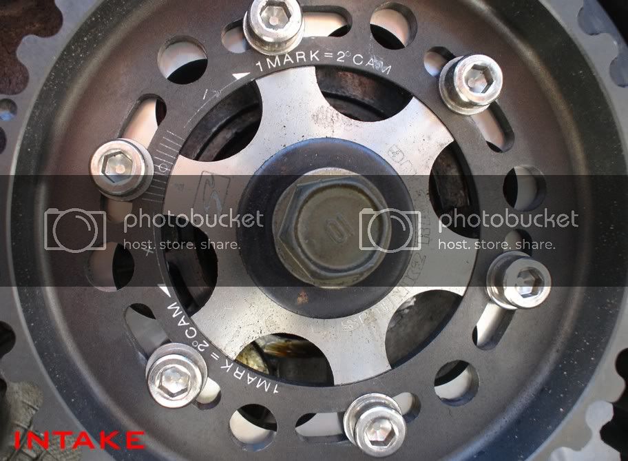

    1 camshaft degree will ALWAYS equal 2 crankshaft degrees...the crank rotates at twice the speed of the camshaft, so for every one complete 360* rotation of the camshaft, the crank has rotated twice...changing your cam gear brand/model doesn't change the gear ratio between the camshaft and the crankshaft...

    He's probably talking about the timing markings in the cam gears which can differ 1 mark meaning 1 degree or 1 mark meaning 2 degrees. I think your picture pretty much settles it for those gears.. lol

    Which wouldnt matter anyways. The only difference is, with one set you would adjust to the fourth mark and with the other it would be the second mark. Pretty simple.

    Right...which is why I didn't say 'move it two marks to the left', I said 'move it four degrees advanced'.
