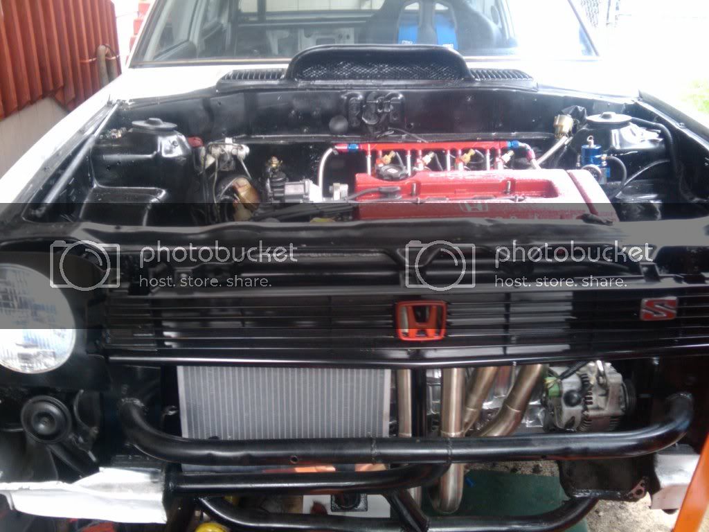

ok i know its not cleaned yet but motor put in just not started yet at this time i have wires that need tucked up and parts still need put on
pics of the motor put in

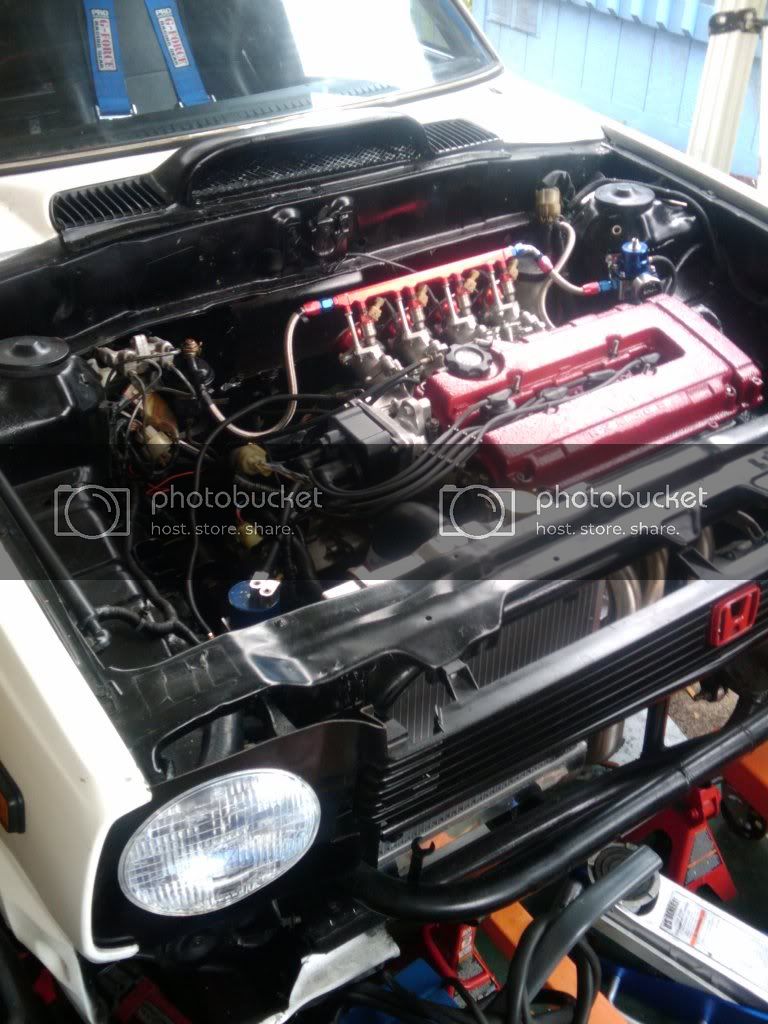

as you can see the ITB's its real close to the fire wall bout less than an 1" but if you look close its cut open where the itbs go air goes into scoop ,then into reservoir to take out pressure and turbulence then 90 into itbs
with out this its to close to fire wall and has no flow

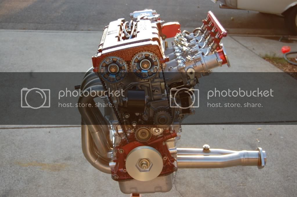

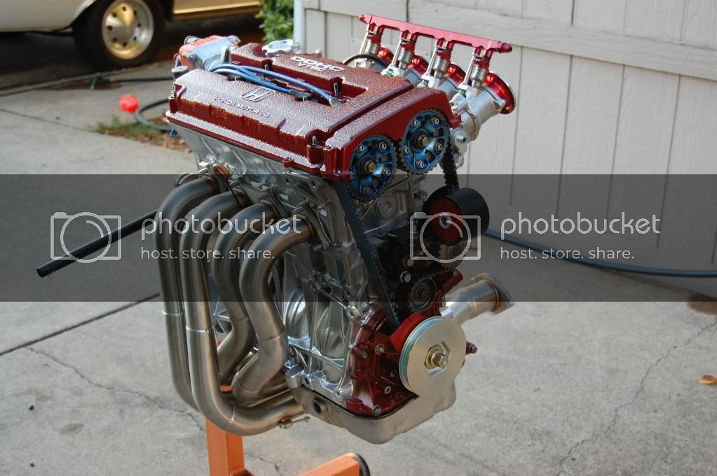

B16B build
New motor B16 just built stage 3 Cams , ITB , CTR pistons, with lill head work.
