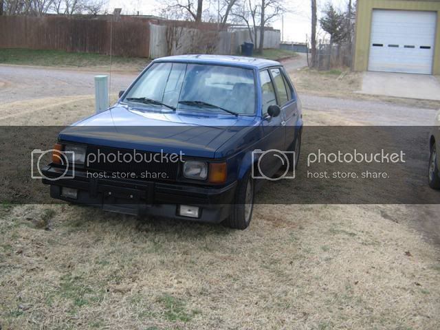

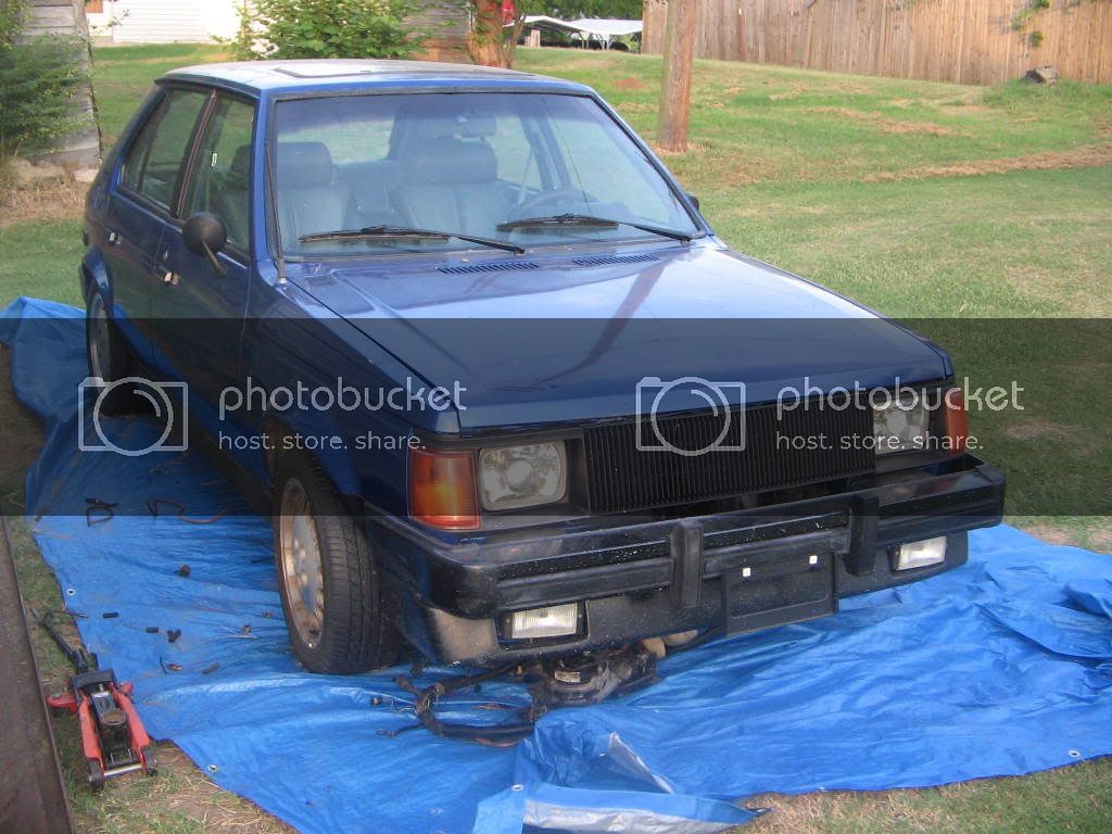

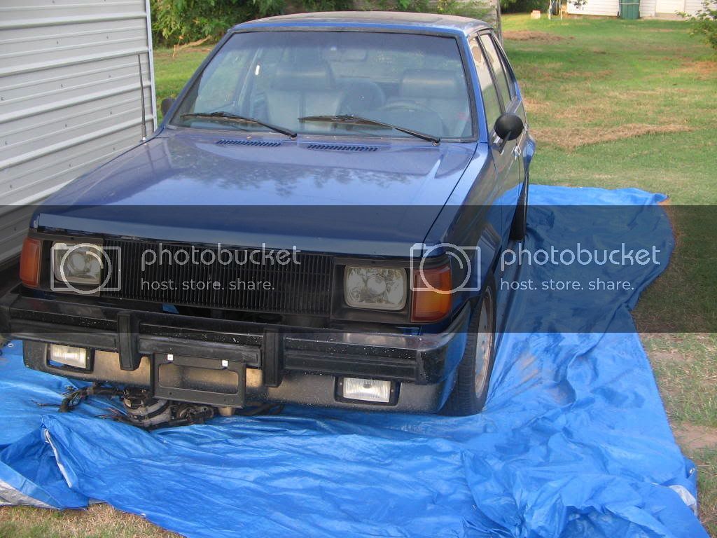

My Blue Demon...

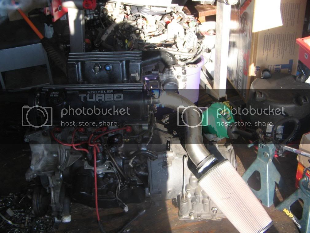

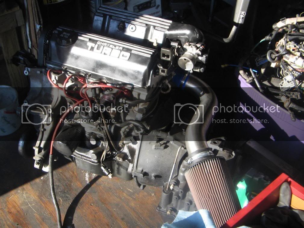

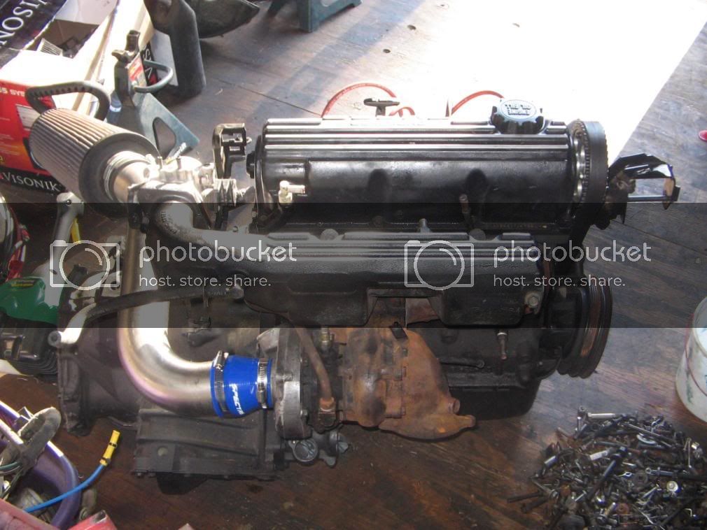

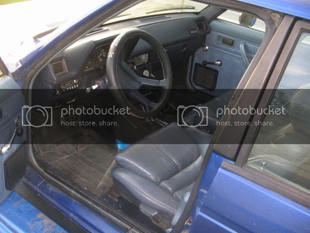

Going Turbo... 2.5(153cid) SOHC 8V engine. Think of the 2.5 as a factory stroker. The setup for now is pretty stock, I just want it to move again. Ported Intake and Exhaust manifolds, bigger throttle body, upgraded turbo(From a Mitsu 13c to a Garrett T03), RFL BOV, Turbo X MBC, Fidanza Adj. cam sprocket, balance shafts removed(should be a 10HP gain), I will do more if I keep it(wanting to sale it). The transmission is an 3speed automatic with a reverse manual valve body(guess that takes the automatic part out of it). NAN torque converter, 2.5" exhaust(turbo back) with a Dynomax ST muffler. The car was setup for autocrossing, but I think the lil thing wants to also go straight and have a chance in winning.... PICS!
Leather power(driver) seats, i even added a sunroof.
