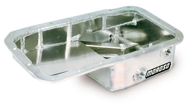

I have a DX manual Civic with a b16a swap in it. Its a minor problem but I am annoyed by it.
I would like some opinions on if I should get my oil pan rethreaded or just replace it with a aftermarket oil pan. Right now it is dripping oil (slowly) because of repeated oil changes has stripped the drain plug. Now I am just asking for opinions on if I should just have the oil pan rethreaded or just get a new aftermarket one.
If I decide to get a aftermarket oil pan, could you all direct me to a website that I can purchase it from.

If you want just a cheap replacement try ebay, like $50-100
eBay Motors: Oil Pan acura honda integra civic GSR B16 B18c1 B18c5 (item 320038619449 end time Oct-22-06 14:55:31 PDT)
But if you want aftermarket go with moroso $300+
Moroso Street/Strip Oil Pans - summitracing.com
is the threads in the oil pan stripped? or is the seal on the drain plug no good, if the seal is toast, replace the seal from honda, if you stripped the threads, you might be able to re tap the threads.
If your going to get a new pan,just buy a oem one.Really no reason to go all out on an aftermarket one unless you have a serious motor.
just buy one of those larger washers (i think they are white) you can find a shucks or napa. quick and easy fix.
Yeah if your oil plug threads are stripped, just buy a OEM one. Better yet, just buy it from someone on this website. I sold one for like $20 shipped, they aren't exspensive at all.

I actually just had this problem.
Cost me $20 and I got an oil change out of it.
Ask a good mechanic to tap the hole for a larger plug... and then install a larger plug. LOL
Easy huh? f-changing the pan.
