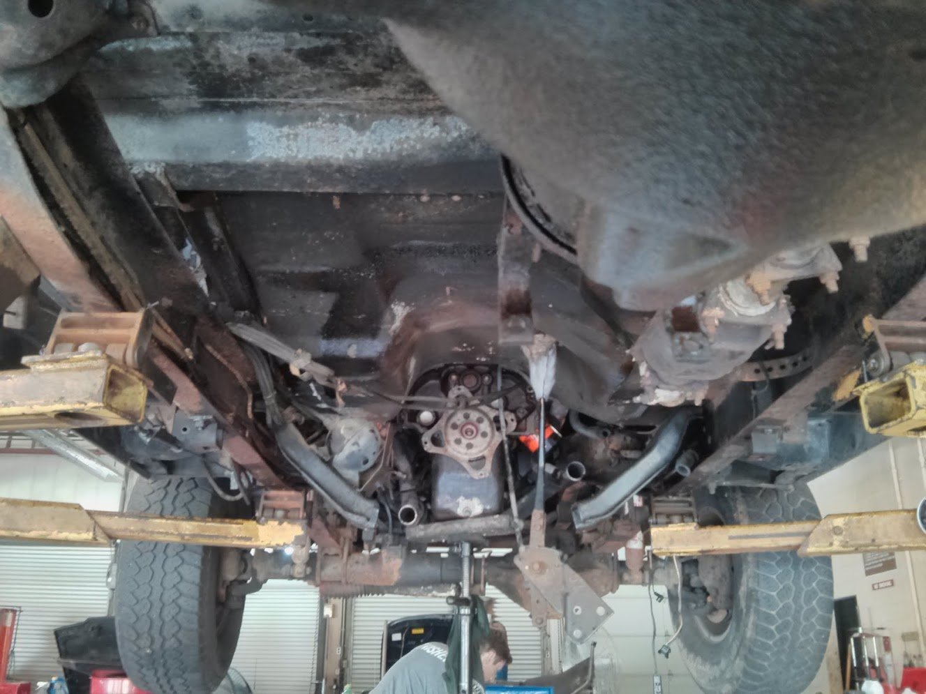

GRSCRXSi and I just pulled the trans. After about 6 hours of work it was out.
Tomorrow I pull the seal, pump, and bushing, and replace with new.

No, we're doing it at a shop.
Eventually I plan on getting a lift in my new house, but that'll be a couple years.

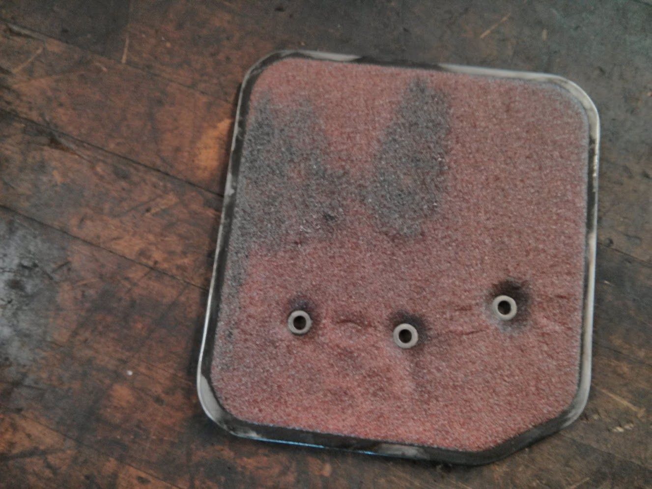

The transmission fluid filter was in bad shape... I don't know if it's ever been changed.
nw6VNv8qIv-_MkOeIxOGQIoWjFhLvW6qVmaXrjKWznw=w1327-h995-no
New one in, and we're good to go.

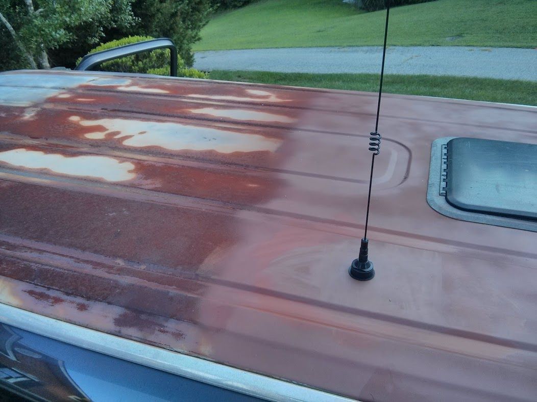

I'm considering painting the roof white once I get everything sanded down and primed. Objections?
white is good... will keep it a little cooler inside. i'm really surprised you havent gutted and cleaned that beast yet.

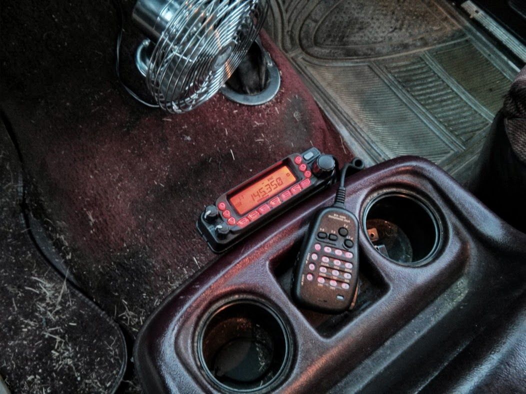

I replaced the battery terminals that looked like a christmas tree, and I have some battery clamp j-hooks somewhere to clamp the battery down, instead of the previous owner's bunji cord. The amateur radio has some 10ga wire running to it, terminating at anderson power pole connectors so I can easily disconnect and/or expand stuff.
The wiring isn't as bad as I thought. It just needs to have a couple pieces re-run (mostly the high-current runs), a couple grounds added, connectors terminated with proper ring-terminals, and some fuses added to the things that are completely unfused.

I got some of the roof rust removed, but that's gonna be a bear to get done without scaffolding, lol.

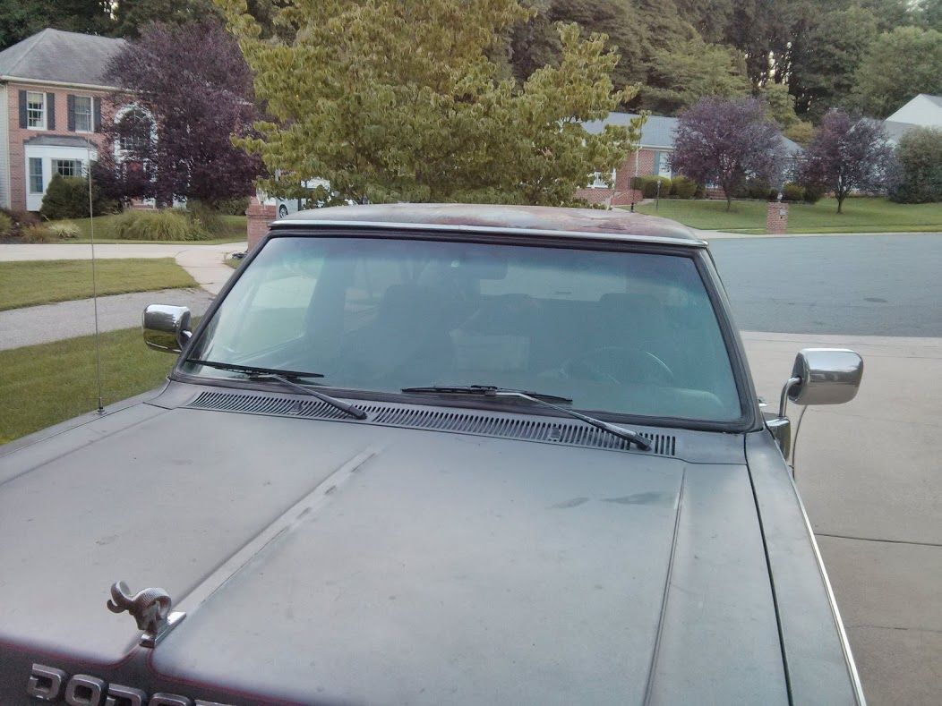

Cleaning the windshield involves climbing up onto the hood of the car, and actually walking across the cowl to reach everything. Putting rain-x on made a HUGE difference, but it's still scratched as hell. I remember reading something about buffing a windshield with a cutting compound to get the scratches and swirls out. Anyone ever used one of those windshield polishing kits?
