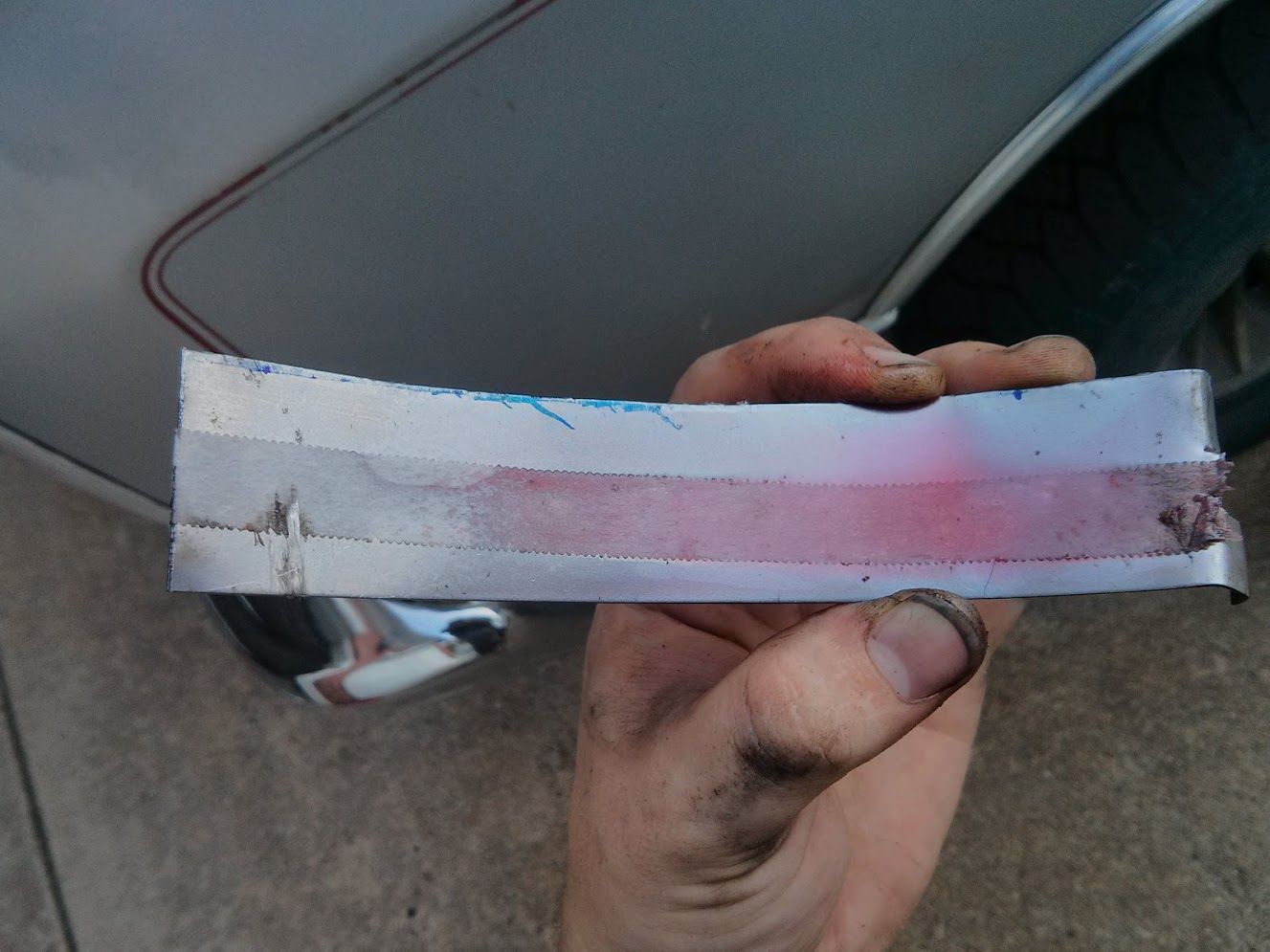

So far, I've pulled the transmission inspection plate to check where the leak is coming from, and yep, sure as shit, it's coming from somewhere in the bell housing. Potentially the seal I just replaced.
Now, what could cause this? Did I fuck something as simple as a seal up?
This same shit is what inevitably did my mirage swap in the last time. Went through 4 rear mains... The crankshaft was grooved where it meets up. Could never get it to seal. Mine was oil, yours is ATF.
I'm going to be getting a new torgue converter along with all new seals, which should fix the issue.
Issue is that I'm closing on a house on the 24th and moving in the following day, week, and weekend, so its going to sit at my dad's house for a couple weeks.
kgteflWD6n6SWAXx3vZdrCvnLUC-ziOndCeGMbNWDi0=w1327-h995-no
Pretty sure it's the torque converter...
I have a "new to me" transmission sitting in my garage right now. 90k-ish miles, ran fine when pulled.
I'm going to swap that into the truck, then do a full rebuild on the original transmission.
