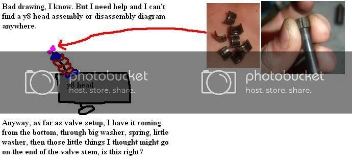

    Now I'm stuck a little more, being that I'm putting this head together myself, there's some parts that I don't quite know what they are. I had the option of having the kid put it back together, but he wanted another $75 bucks, and I didn't think it was worth it.
    [​IMG][​IMG]

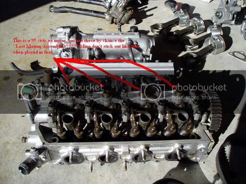

    Lost Motion Assemblies, clueless as to where they go. Haynes manual says to remove them and inspect them and how to inspect them, and I've done it but it doesn't say where they go.

    You need to buy a service manual. Don't guess your way through assembling a head.

    So I just bought a haynes manual, they didn't have helms. I was indeed right in my correction of what the "little things" are used for. They are indeed the keepers, and go on the top of the valve, so now that thats settled, I'm under way

    also, I figured out some names, but unsure of location?
    ^lost motion assemblies
    I found from my handy new manual that these are lost motion assemblies, whatever they do, I can't find where they go. I'm reading through the entire head disassembly and the only thing I can find on them is to check them to make sure you can push them down with a finger force

    :) Problem Solved I think
