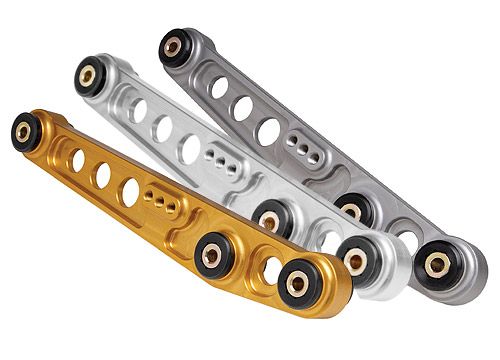

    going to pick up some Skunk2 LCA's, just want to make sure a Stock OEM Rear Sway will bolt up to the Skunk2 LCA.
  13. GlassHeadlights
    4,066
    71
    Oct 24, 2007
    Calgary, AB
    I hear Skunk2 LCAs have bad bushings. But yes they will work, they have 3 positions for a sway bar I believe.

    PIC (Power In Control) LCA's are good stuff. I've had mine on for a couple years now and about 30k miles and they're still holding up pretty well. They've been through quite a few autocrosses now too.
    Buy Standard Rear Lower Control Arm
