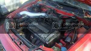

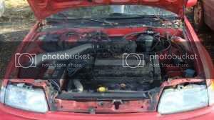

    I'm looking into doing an auto2manual and b16a1 into 1999 civic. With 1991 Civic donor car!!
    I've read a lot, and I know the b16a1 is cable tranny, which will work in favour for me as I'm converting auto2manual. It just seems a lot easier to run the cable rather then the hydro correct?
    The motor is presently swapped in a 1991 Civic, so my plans are using that as a donor car and taking clutch parts, pedals, linkage, etc and swapping auto2manual in my car.
    The other thing is mounts, and power steering. 1991 Civic doesn't have power steering but the motor has power steering on it. Can I just hook up the power steering from my car?
    And will the present mounts work on the 1999 civic?

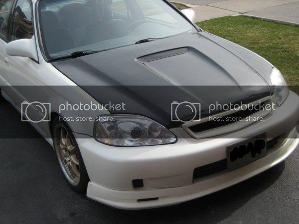

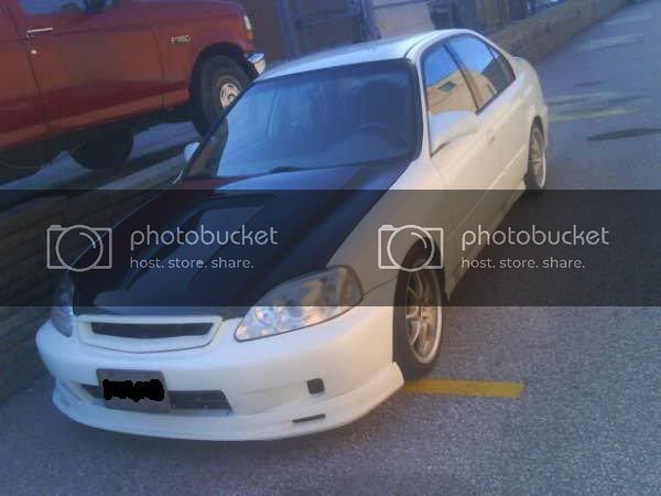

    My car:
    Donor car 1991 civic:
