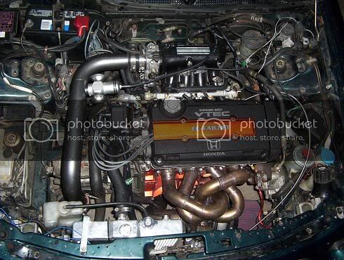

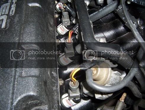

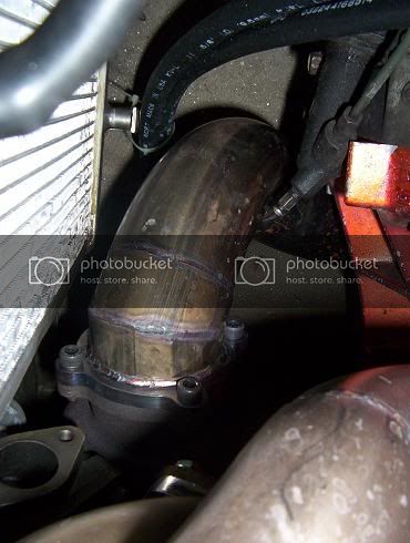

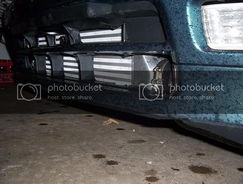

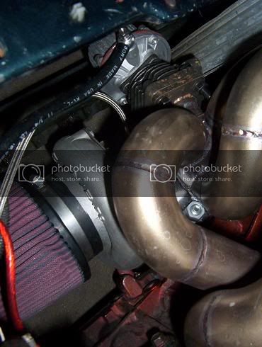

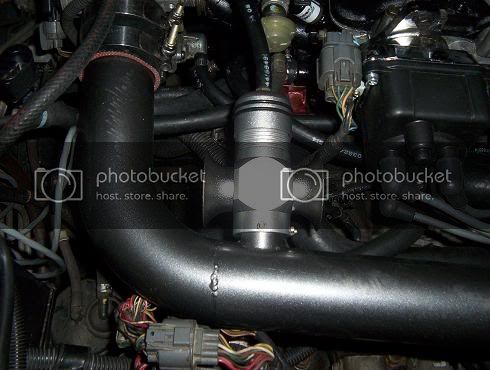

WELL HERE ARE A FEW TEASER SHOTS, jordan and i installed the kit under a tent made of tarps in the freaking rain all day. kit came out serverly clean, and this turbo is a whale, i dont even start to see any boost until around 4k. but when it hits, its fucking rediculous. car is a dog out of boost due to the super low 7.9:1 compression, but when it sees boost it peps right the fuck up. its pretty obvious this thing will have zero low end and hardly any midrange powerband. can you say vicious lopsided topend?? i can :S
setup is as follows,
7.9:1 comp .10 over b16a devconed block, srp pistons eagle rods, stock head.
.63ar gt35r
hotrex custom "party girl" manifold
precision 780s
xoxo racing dual trumpeter bov, sounds knarly, seriously.
2.5 inch charge pipes,
AsIaN PeRsUaTiOn 29x9x3 bar and rice intercooler
3 inch stainless dp with flex
3 inch half exhaust, ( pipe with resonator cut off behind seats) turbohf style
plx m300
turbosmart 2 stg boost controller
tuned by chris ( xenocron) on crome pro.
planning to eat 20 plus psi. she kicks
on with a few pics.

with my 4 inch k&n on it, its not as jungle fever as you think, but it hits like a metric ton of bricks.

saw this one HMT also. Nice job, glad to hear your happy with it. You running open DP? If not that might help your spool time by about 200rpm :p.
