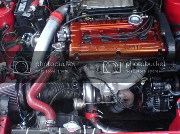

my old awd dsm w/ buschur 20g, fmic, 2g maf, evo9 inj, 255 fuel pump, 3" open downpipe.....FAST (and no pic is not of all above mods)
OH yea and a civic radiator thats zip tied in...sweet i know...lol garage built dsm gotta love it...still owned a z06 in kent in front of 200 ppl lmao

nice job on the DSM. i love how you ran the pipes. ive seen some cluttered bays, that one looks great.
if you dropped your AC, think about getting the alternator relocation bracket to hide it on the back of the motor where the AC used to go.
they also make clear timing belt covers now.

thanks, i wish i had a finished shot of engine bay... i did a wire tuck, and with 2g maf it looked way cleaner. i made fmic piping shortest route possible...i really love 4g63 motor, power is endless and their so strong..yes they have their lil mess ups but all in all its a well engineered and designed engine.
