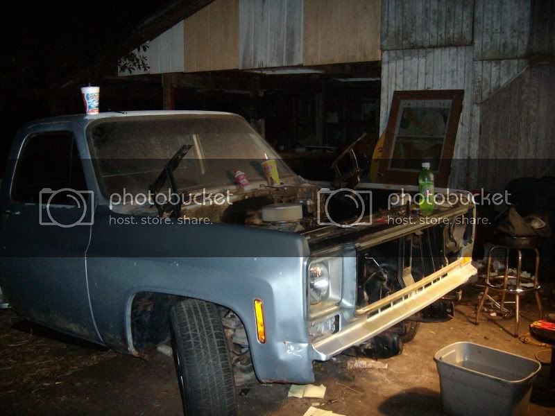

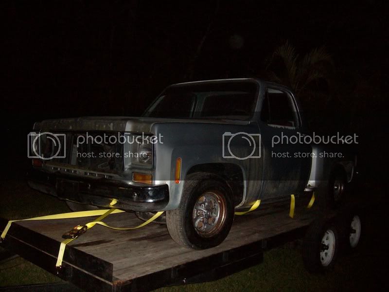

    Just got her the other night. Paid 750 for her.

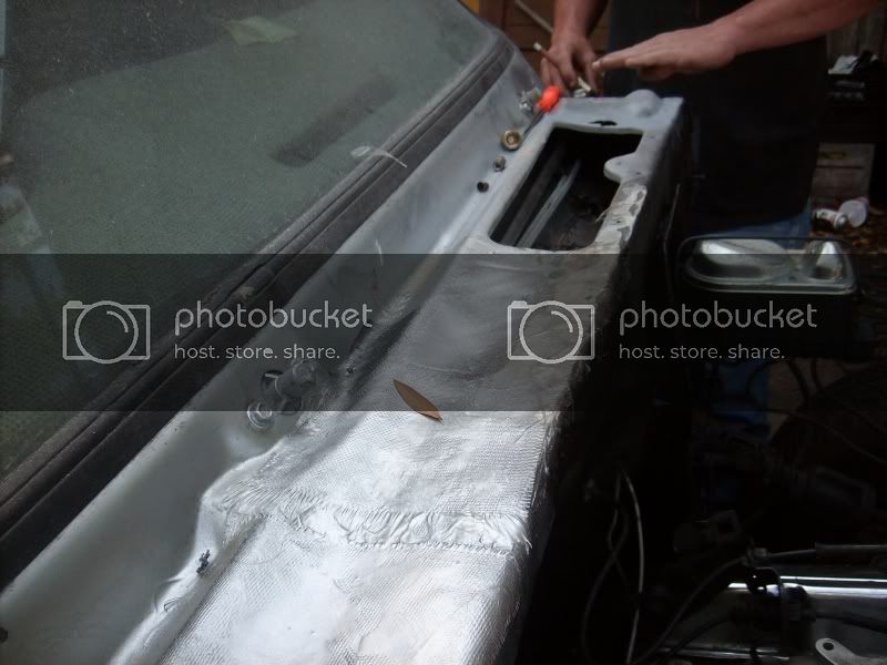

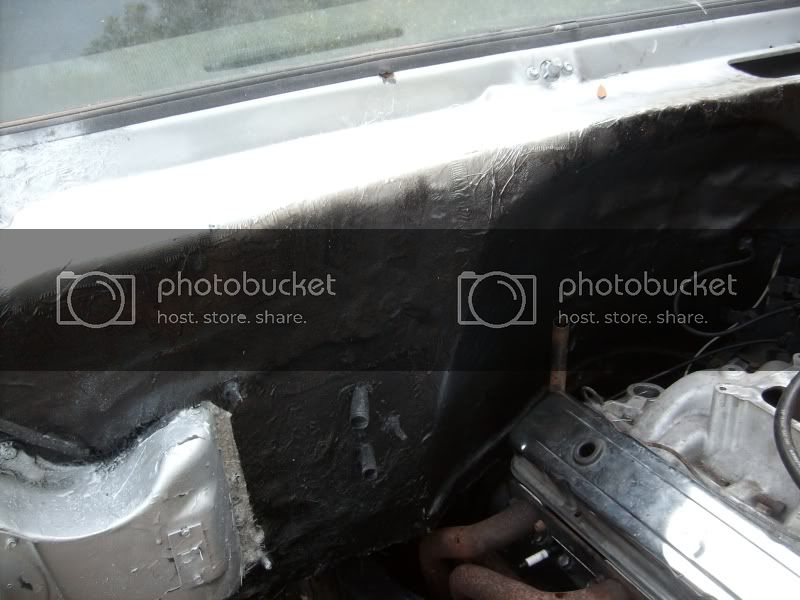

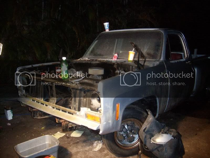

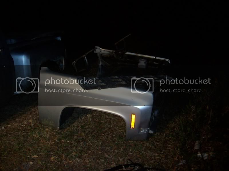

    Someone spent the time in her before I got her. They went out and got new carpet and insulation, decent interior parts, headers, full dual exhaust, supposedly rebuilt the transmission, and its lowered. The only down fall, they didnt finish the project, needs a wire harness, didnt protect the wood bed so its starting to rot, and didnt take out the moisture before paint. So now rust is bubbling out of the paint. the worst of the rust is on the fire wall, tomrrow I'm pulling off the fenders and engine, then curing the rust out, sealing it, then fiberglassing the firewall up. Like the title says. Project

    nice truck!, what are your future goals for this thing? LS6? :p

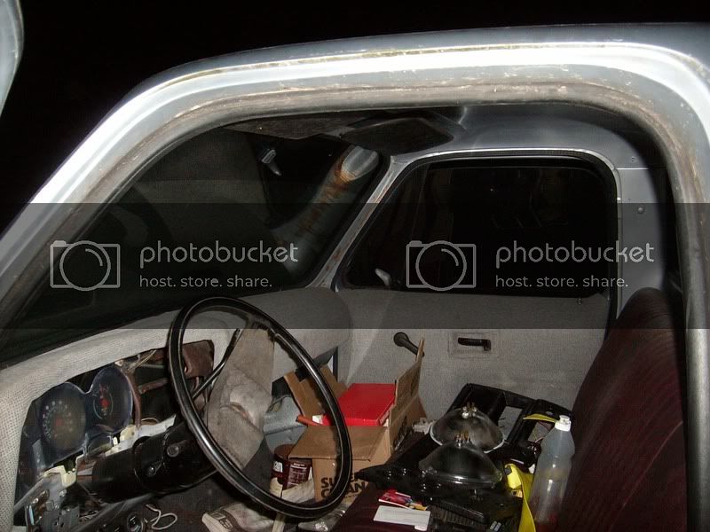

    nice truck. What are you doing for rims? The dash and door panels need to go.

    those trucks do look good laid down. you shud get rid of the step side bed tho those are so ugly. and keep the tweed interior it looks good kinda retro lookin.

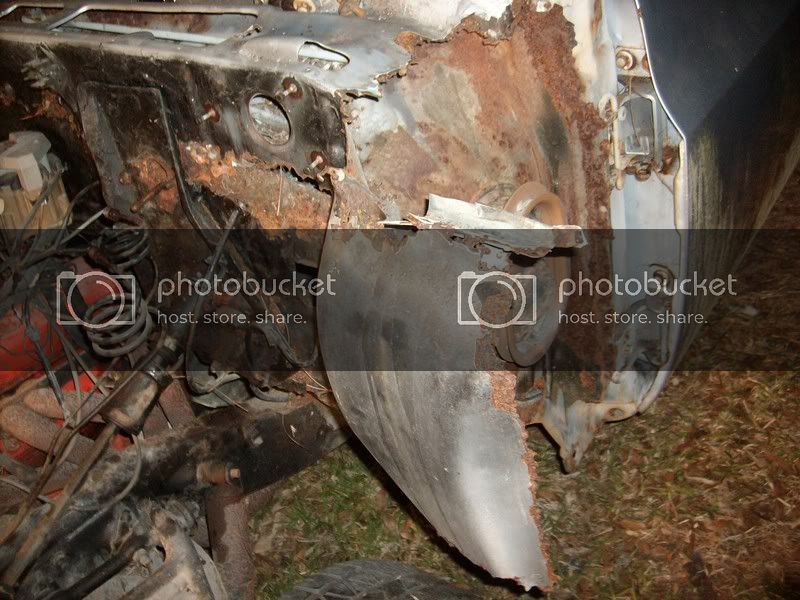

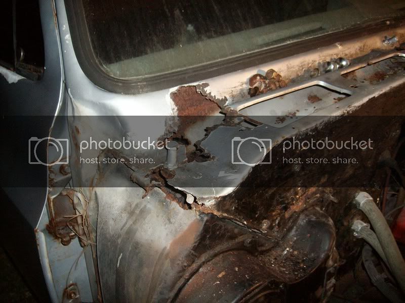

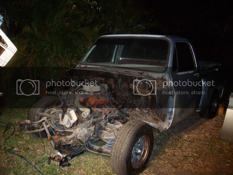

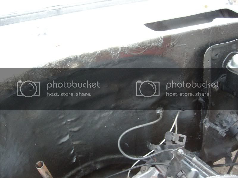

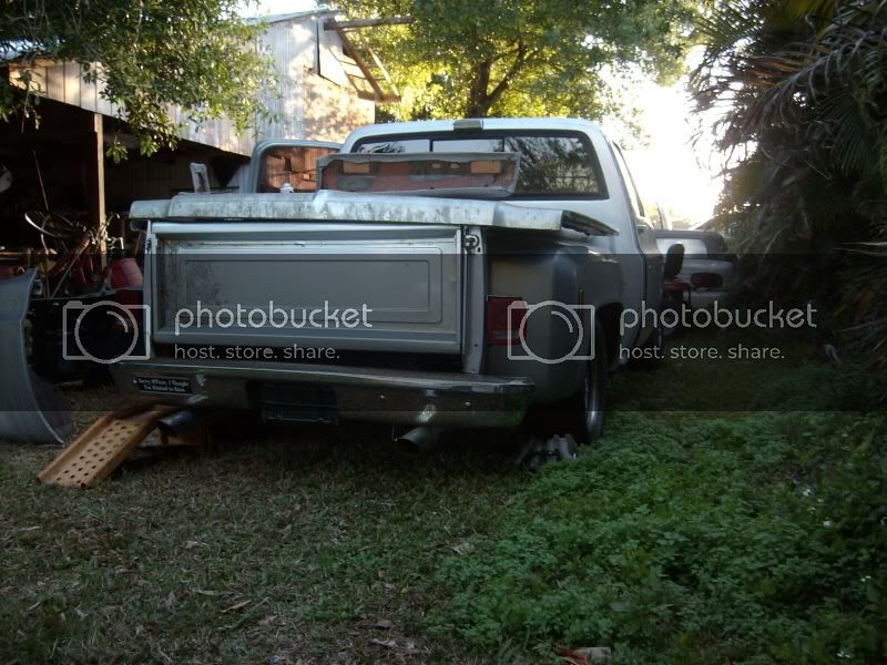

    Its been awhile since an update or any pics have been added. but here it is.
    I need to clean it up some though. some sanding, bondo work, and paint.

    Wow, I was digging the nice clean shell, but that is some freaking terrible rot underneath. You should look into getting a new cab from the junk yard. Probably only cost you 3-400 at a pick and pull if you wanted to do all the work.

    So, I found out the specs on the engine.
    Its a 72 Camaro Z28 350, flat top pistons, 63 202 Racing heads, stainless valves, dual valve springs, aluminum intake, 600 cfm Edlebrock (I bought it for the truck)
    the engine hasnt been dyno'ed but its said to possibly put out atleast 300 with proper tuning and carb. has 11:1 compression though. I cant keep the starter from torqueing out starter bolts. So I got the bracket for the back of the starter and now I just have to play with it to get it right and stay right.
