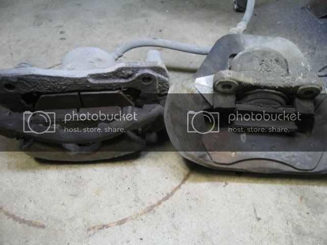

Here's a shot of each brake caliper. As you can see, the Integra has about twice the pad surface area.

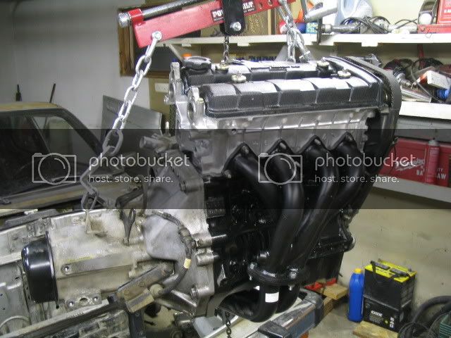

Yay for Cheap-ass Headers!

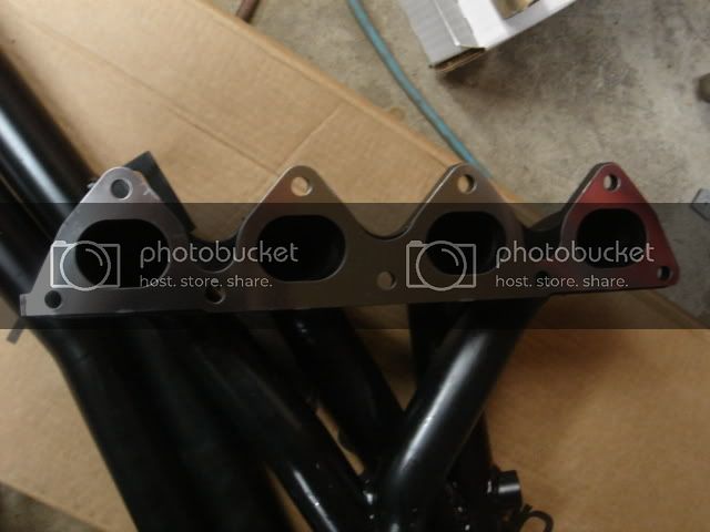

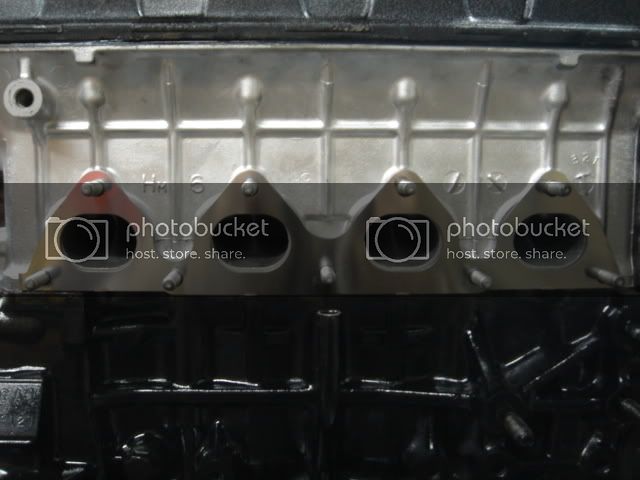

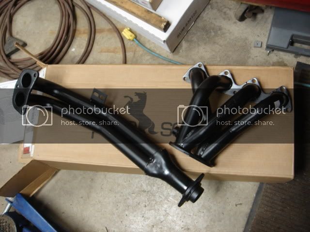

So I bought some Pace-Setter headers. As most of you probly know, bolt-on they're not. I compared the exhaust gasket to the head and it didn't lign up worth a shit, so I thought I would have to grind out the stud holes, and port match it. Luckily when i put the gasket up to the header, it was off by about the same amount. Long story short, the gasket they give you is bogus.
with an OEM gasket, Everything lined up, except the bracket that is attached to the downpipe. So it was time to learn how to weld...

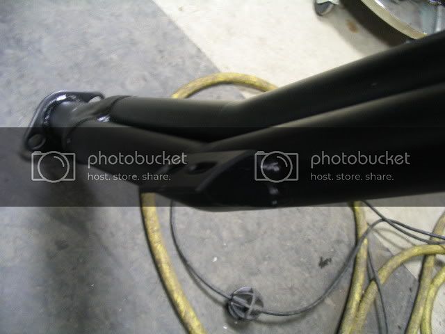

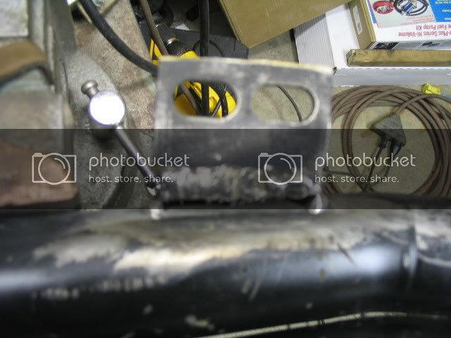

Here's how far off the bracket was.
So I had to do a little customization

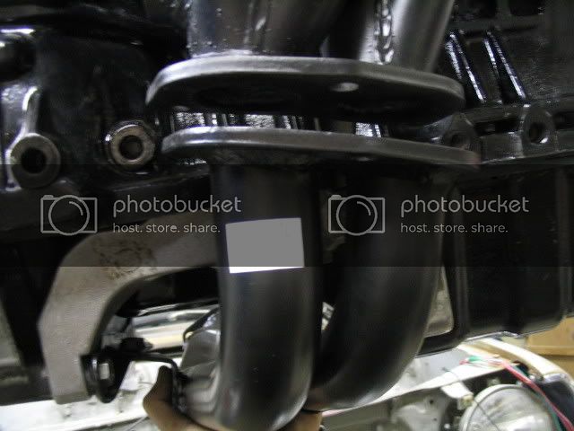

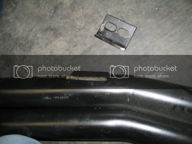

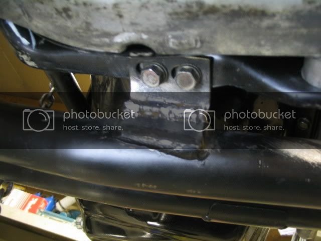

After bolting it back up, I had to bend some steel to get it close enough to weld.
After Spotting it in place, I took it out and ran some welds across it. They aren't pretty, but it's strong enough to hold.

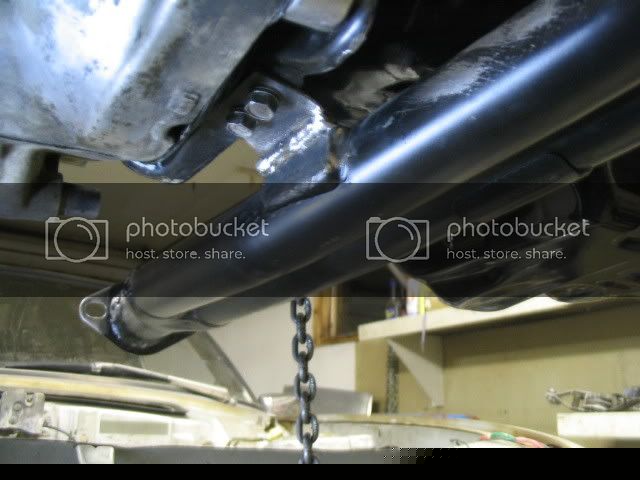

Here's some final shots of it installed.
You get what you pay for.

Cheap header Cheaper gasket

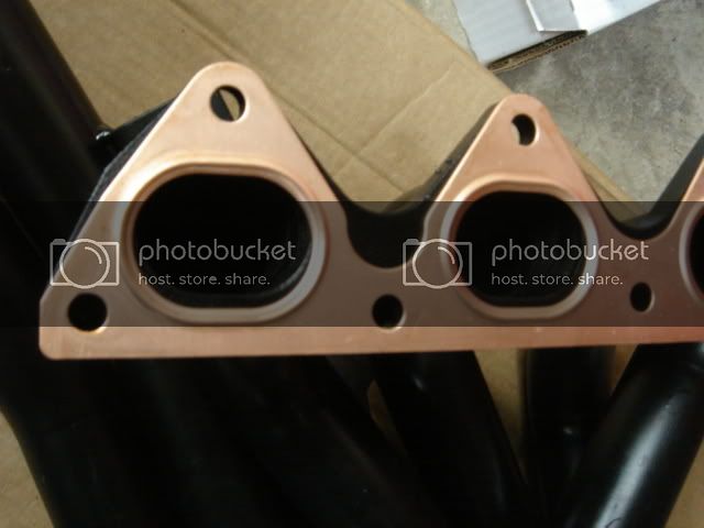

Here's what i was talking about the gasket (the copper one was included with the header)
I put the gasket on the head and almost shit a brick cuz I thought the header was the same way.
Luckily it was off by the same amount on the header.
The OEM gasket lined up like a dream.
Just a warning if you buy a pace setter header. Check and make sure everything fits right. Like I said, It's not bolt-on.
