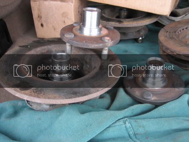

Hubs are done!
Got the hubs back from the machine shop. They did a nice job. Still waiting for the seals to come in so i can get it all pressed back together.​
Before:
After:

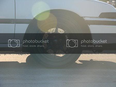

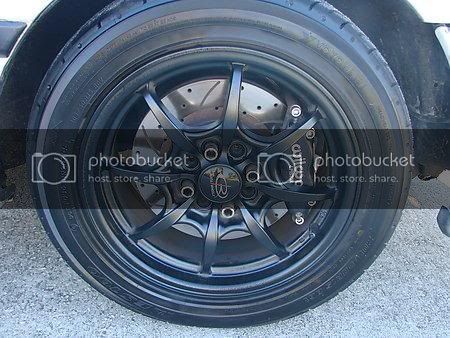

I was thinkin about buyin this guy's brakes :drool:
But he wants $600 for 'em and they're 11 inch rotors, so I gotta use 15 inch rims minimum. I doubt I'll actually get em, but that would be SOOOO sweet.
Whatever, the stock teg brakes will give me more stopping power than I'll ever need, those would be overkill, and only good for looks.
I'd put the $600 somewhere else, like cams or ITB's or something cool. Teggy brakes will be more than enough for a CVCC.
