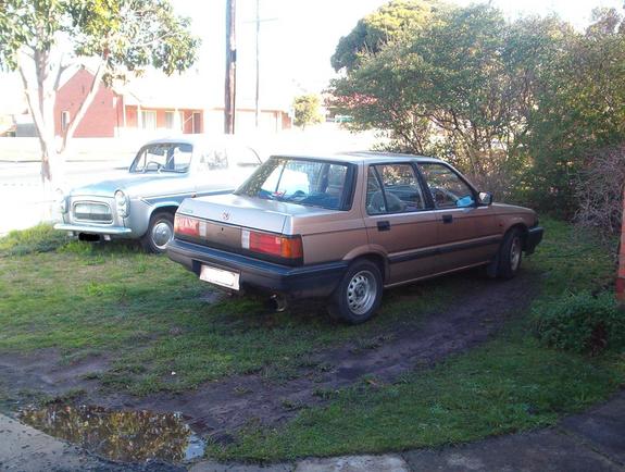

This is close to what mine looks like
carbuereted (sp*), very difficult to swap. You need new fuel lines, pump, a entire harness for the engine......not worth the all that effort to just get a old CRX Si or gen1 teg motor in there.
