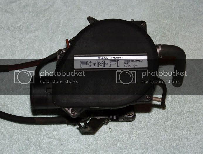

what kind of injected crx si or dx because dx is the same sized head if you got an injector that looks like this
its dx, a 1.5l head same as carbed
Your biggest job is the wiring, its not just a matter of swapping ecus you are going to have to change the whole loom because alot of wires will be missing from the carbed engine along with sensors, dont mess around with the DX dual point setup you should stick with the full EFI, all the 12 valve heads are the same and all the 16valve heads are the same but dont try and mix a 16valve head and a 12 valve block or vise versa. The best swap is a twincam ZC 89 on along with its loom and sensors and fit a chipped OBDO ecu, in Australia we got the 1st gen CRX with
