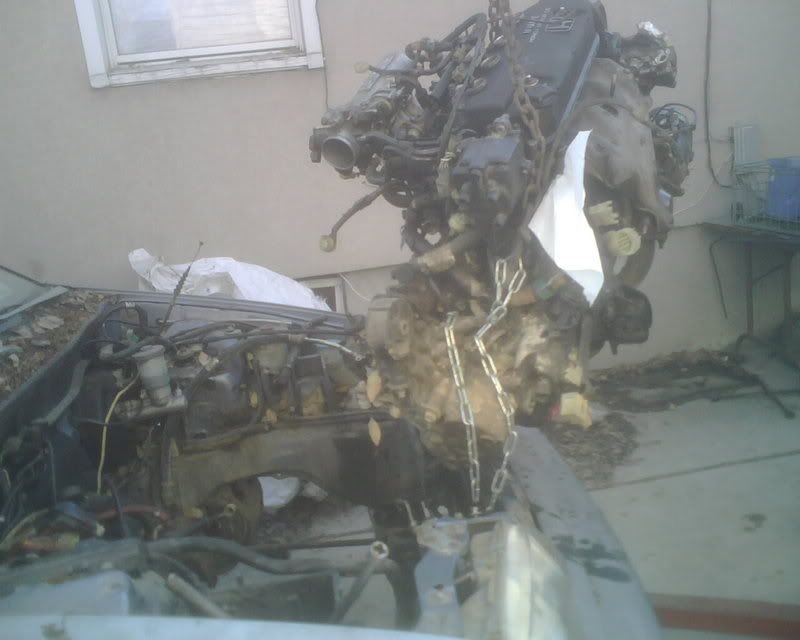

    Okay this project has been started and as of right now the engine bay of the 1988 is cleaned out, the motor is out, the crank pulley off both motors to swap the drivers side motor mount. What I have left
    Swap the motor mount to the d16z6
    put the casing back on and crank pulley.
    put oil in
    plug the rywire stuff in motor back in the engine. bolt tranny up.anyways la de da de da.... soon but here is some pictures of what has been done :) enjoy!!
    <a href="IMG00597.jpg picture by jessetaggart - Photobucket" target="_blank"><img src="http://i119.photobucket.com/albums/o131/jessetaggart/IMG00597.jpg" border="0" alt="Photobucket"></a>
    <a href="IMG00598.jpg picture by jessetaggart - Photobucket" target="_blank"><img src="http://i119.photobucket.com/albums/o131/jessetaggart/IMG00598.jpg" border="0" alt="Photobucket"></a>
    <a href="IMG00599.jpg picture by jessetaggart - Photobucket" target="_blank"><img src="http://i119.photobucket.com/albums/o131/jessetaggart/IMG00599.jpg" border="0" alt="Photobucket"></a>
    <a href="IMG00600.jpg picture by jessetaggart - Photobucket" target="_blank"><img src="http://i119.photobucket.com/albums/o131/jessetaggart/IMG00600.jpg" border="0" alt="Photobucket"></a>
    <a href="IMG00601.jpg picture by jessetaggart - Photobucket" target="_blank"><img src="http://i119.photobucket.com/albums/o131/jessetaggart/IMG00601.jpg" border="0" alt="Photobucket"></a>
    <a href="IMG00602.jpg picture by jessetaggart - Photobucket" target="_blank"><img src="http://i119.photobucket.com/albums/o131/jessetaggart/IMG00602.jpg" border="0" alt="Photobucket"></a>
    Not to much left, I have everything just need to put it all together :) Will keep updated, I just got back 20 minutes ago from getting the crank pulleys off, thanks guys :)
