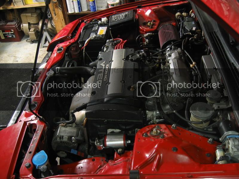

Here is a H22 just freshly dropped into the Lude after this member purchased a set on a group buy that I ran in October last year.
Now I hope this points you in the right direction.
