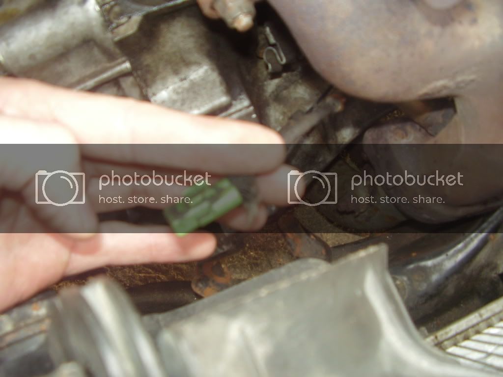

    1 wire for O2 sensor was un hooked I hooked it back up and noticed another wire that had nowhere to hook up, it's the green one in pics,

    That Green One Is The Secound 02 Sensor Wire.

    what does it hook up to? I hooked up the white one and it does run a little better, but not right yet.

    thats the secound o2 wire, the b16 has 2 o2 sensors. somtimes people put aftermarket headers thats only have 1 o2 bunge. you need to get one welded in or if you have it hook it up.

    I have the stock header, I will jack it up tomorrow and look for another o2 sensor.

    The stock b16 exhaust mani has both o2's in the headers. There right next to each other...Like this. [​IMG]

    does the wire for that one go to the ecu. because I cant find what it plugs into.just got the car and the wires are spaghetti city, tomorrow I'll take a pic of the wiring job that I will be re-doing. I wanted to get it running straight, then run the wires through the firewall istead of through the door, then if that goes OK a wire tuck. (wish me luck)

    yea the second wire goes to the ecu.
