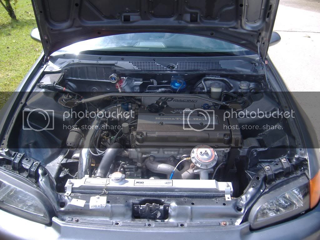

A buddy of mine said he has a lsvtec oil line kit that he would sell me for cheap. What do you think about the LS block, B16 head, and b16 tranny? I have a highway car already so I dont mind the short gears. (Built gsr runnin boost with ls tranny)
there's more things needed to properly build an ls/vtec engine, i agree with D16siHatch, i'd build the bottom end and top of the b16 and boost it for major fun lol, I'd fund all of it with the extra engines that u have laying around ; ).
Already got one...lol fully built gsr at 18psi....
