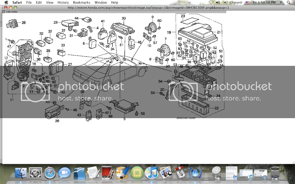

    Alright the "flasher unit" looks like a relay (it actually is, I believe). They should have them at any parts store. You would be looking for it to be at the driver's feet somewhere. I know that's vague, but as I said originally on the new accords it's actually in the fuse panel at the driver's feet at the top above the fuses (its a black square box about 5 times bigger than a fuse). It could possibly be behind that panel below the steering column in the vicinity of the main relay. It should have some sort of writing on it indicating.. well tell you what, I will do the legwork for you, my next post will show you exactly where it is....
  6. f22b1 coupe
    f22b1 coupe Junior Member
    346
    14
    Dec 30, 2005
    Indiana
    You need to replace flasher unit relay, item #25 in this photo:

    ok so after another trip to autozone i finally got a turn signal flasher relay. not sure if that is the technical term for it or not but you all get the point. so i found it is in the driver side kick panel above the ICU.
    now it says in the haynes manual the new and old relay should look identical. now i am a pretty big guy and its a little difficult for me to get under there. i have pretty big hands and there is very little room under there. so there are 3 relays there all looking similiar. the leftmost i dont think is it. it says its 12.8V on it and the one the autozone guy sold me says its 12V. the middle one looks a little too small(i think) so i think its the one on the left. problem is there is VERY little clearance between that and the clutch pedal housing (its the shit connected to the clutch pedal) i cant even tell if that is the right relay or not. i can barely get my head under there. and i cant tell if it needs to be pryed out or pulled out i cant see it. i cant even tell if its a 12V also.

    Well I don't know if the 94-97 uses the same location or not, but when I thought mine had gone out (it hadn't I was just an idiot and left my flasher button unplugged when I did a stereo ipod plug in that involved pulling the dash apart) I got a unit from auto zone, and it didn't fit. It literally would have been impossible to get it into the fuse panel. I forget whether it was the one on the left or the middle one, but IIRC it was the middle one. As for the fastener clip on it, yeah, those are a nitch- I used a Swiss Army Knife, flat blade screwdriver, a leatherman, all kinds of stuff and finally got it, but the real trick is using light and a fine instrument (whatever that may be) and working at it- I tried brute force and got the feeling I was going to break something and regret it before I was going to overpower that thing. I should have mentioned auto zone is a poor choice to get a replacement, unfortunately. The dealer I think gets something like $20 which is painful! But if that's the problem, small price to pay. I'd get it at Honda. Btw, here is an easy way to mentally keep track of which one it should be. It's the second row down, and the first one in from the left that is horizontal rather than vertical. Looks like there are only 6 relays actually on that fuse block.

    awesome thanks for the help. you are totally right about the relay from autozone being shit. it is too big. i went to teh honda dealership today trying to buy hondabond for my valve replacement and the relay if they had it. also to pick the guys brain but he was not much help. he did show me the relay though and i think its the middle one. it was wrapped in bubble wrap so i couldnt tell exactly. the bad thing about that is they want like $43 and change. and if its the signal switch they want like $170 for that lol. i was like yeah ok bro junkyard it is then. im not even sure which one it is. i am pretty sure its one of the two though. well screw it even if i cant fix it i live in vegas people drive like assholes here anyway so who needs a turn signal.

    Haha, so are you in Vegas to live for awhile or are you on vacation or something? If it's a vacation, this is the worst trip (automotively) ever :/ Anyway, they are trying to rape you hard at the dealer, my local dealer who really sticks it in deep still only sells the relay for like $24. You're right that salvage will do- it's a common car to be in the yard. And I am pretty sure it's the second one in on the fuse block judging by the picture. As I said before, I seriously, seriously doubt it's the switch having seen firsthand the near foolproof design of the internals of the switch. If I were you I'd buy one online and pay for express shipping and still come out ahead- but that's assuming you have an address you can ship to in Vegas.
