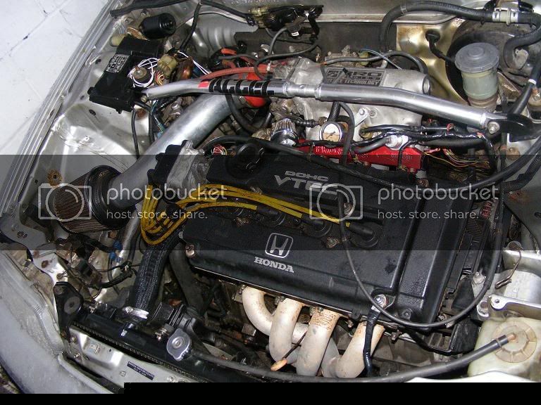

    Honestly if i can get enough money up i might do a b16 swap.
    http://hmotorsonline.com/shop/sc2000search.cgi?what=page&item=30001
    Aint she sexy?
  8. LILBLKCRXSI
    LILBLKCRXSI New Member
    70
    Oct 30, 2008
    yeah FOR THAT MUCH you might as well buy my crx,a newer engine than that and comes with free hasport mounts, skunk2 mani, skunk2 coilovers and a lot more and it's only 50 dollars more, AND it has a crx that comes with it hahahahaha,this is ridiculous, i can't believe it's this hard to sell my crx , it's the cheap as gas that's faken me, sorry for the rant but yeah, think about it ;).
    ps: you can part out the crx and get at least 500 back no kidding lol.
