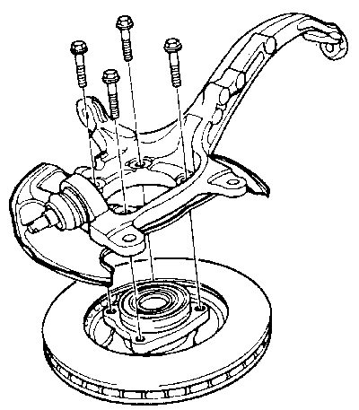

    No the rotors are not pressed on, but it is quite difficult to get them off. In the repair manual for the car it will state clearly that they can be removed once all the 12pt bolts are taken out, but they do usually have to be pressed off. They get wedged on there pretty tightly do to the heat generated from breaking
  8. nootrac22
    4,322
    131
    Mar 16, 2007
    exeter pa
    1. If equipped with an air bag, disconnect the negative battery cable and properly disable the Supplemental Restraint System (SRS), as detailed in Section 6 of this manual.
    2. Loosen the lug nuts, then Raise and safely support the vehicle on jackstands.
    3. Remove the wheels.
    4. Remove the steering knuckle from the vehicle. Please refer to Section 8 for procedures.
    5. Remove the 4 bolts retaining the hub unit to the steering knuckle and remove the hub unit.
    Remove the 4 bolts retaining the hub unit to the steering knuckle and remove the hub unit/rotor assembly

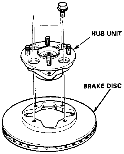

    1. Remove the 4 bolts, then separate the hub unit from the brake rotor.
    Click to Enlarge
    To install:
    1. Assemble the disc to the hub unit and tighten the bolts to 40 ft. lbs. (55 Nm).
    2. When installing the hub to the knuckle, use new self-locking bolts and tighten them to 33 ft. lbs. (45 Nm).
    3. Install the steering knuckle.
    4. Lower the vehicle and check for proper brake operation.
    5. If equipped, enable the SRS system and connect the negative battery cable.
