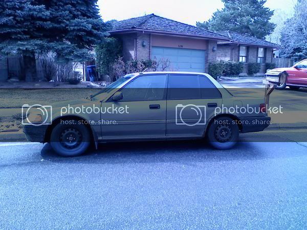

so ive read some places that the springs form 88-00 are interchangable. i put some on my car and the front seams high to me. jsut curiouse if you guys have any info that might help...
what do you think?
http://i494.photobucket.com/albums/rr309/tdogg_024/civic2.jpg
The springs are different lengths / rates per platform- if you buy sleeve mounted adjustable springs you can physically mount them onto any 88-00 Civic and get the ride heights right, but fixed height springs aren't going to directly swap between generations with the advertised height results.
