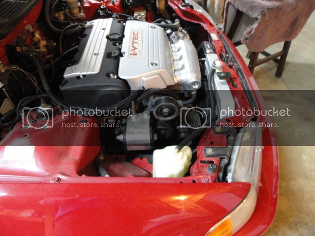

You probably don't have the right tensioner. If the motor had PS (all K20A2's did) then you need to replace with a different tensioner.
Mine is (if memory serves me) off a 06-11 Civic Si. They have electric PS so no pump.
Trouble with my photobucket account (super slow) but I found this.
