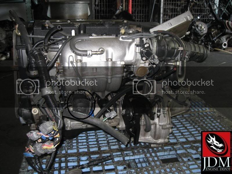

Thanks for the links that black box thats on the back of the h22 and not on the f22 can someone tell me what to do with that. Mine is 93 ex coupe not 92.
That black box

I believe the black box is for the IAB stuff, and since you have an EX, you shouldn't have to wire anything for the IAB. EX accords for 92 and 93 had the intake manifolds with the butterflies.
I'm about 90% sure that the black box somehow "meters" vacuum so the secondaries only open when the computer tells the switch to let the vacuum through.
