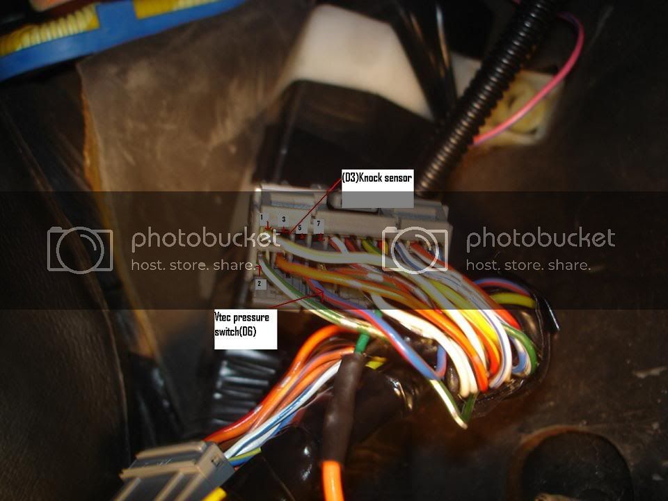

heres a picture of the pinouts
and here is how to count them. you sholdnt have to worry about the knock sensor since you should have it.
uhh, yeah what he said. the knock sensor SHOULD be on your harness, if not, youll have to wire it up. Some people say that the h23 has one from the factory ( i know mine did ) others say they dont...i dunno, maybe certain year h23s didnt, but i know mine sure as hell did.
