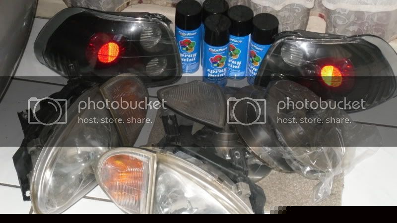

    Finally my stock taillights arrived that I bought on eBay for $64.28 shipped. I took off the old Altezza's and went back to the stock look.

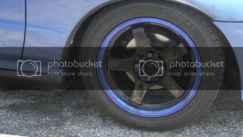

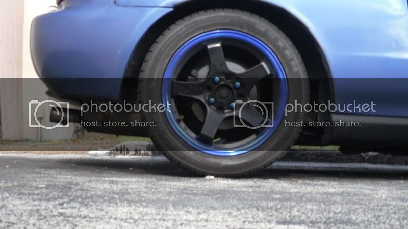

    My blue locking lutnuts came in the mail so I put the new rims on the Sol and snapped a few pics. As you can see it's starting to look much better than it did when I first got it.

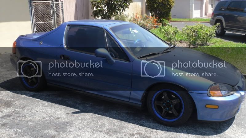

    I got tired of driving around with this ugly ass rusted hood. Took a trip to Walmart and got the cheapest paint I could find lol. I bought 5 cans of Color-Place for $0.98 each. Then I went to Home Depot and bought a pack of 120 grit sandpaper for like $2.67. Went back home and took off the hood and took it around to the backyard where I sanded it and sprayed it black. It only took 2 1/2 cans of paint to get it glossy black. I let it dry for a few hours and watched my beauty shine. =)
    Mar 7, 2010

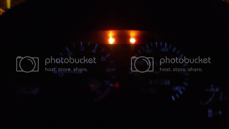

    I bought some red, blue, & amber colored leds to install in my gauge cluster and climate control. Pretty easy to install and looks nice. However, the screw that holds the climate control in place got stripped in the process since I got fustrated that I couldn't get it out. So I gave up on the climate control lights for now until I could decide what to do about it.

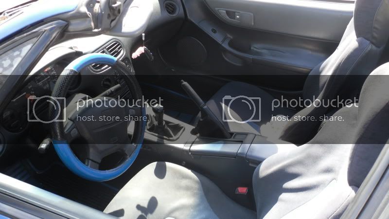

    Well I like the all black interior of the 96-97 del Sol's so I decided to paint the few gray interior pieces black. I'm trying to get a little theme going on so tomorrow I'm going to buy some fabric so I can rewrap the gray speaker, center, and door panels. Since I don't have Motegi interior, I might as well make me own :)
    ___________________
    The only gray pieces I'll have left is the door handles and sun visors. Since the OEM black door handles aren't hard to find I'll pick up a set of those instead of painting them, plus the drivers side handle is broken anyway.
    I'll have interior shots tomorrow after the panels are wrapped.

    So today I went out and bought some simple blue colored fabric. Only paid $9 for 2 yards which is more than enough. I think I did a good job with the targa top but the side panels were a PITA. The fabric I had didn't consist of a stretchy material so I wasn't able to make the side panels nice, smooth, and flush. For now I'll let it slide but I'm positive I'm going to redo them very soon since the Sol can't settle for imperfection.
    This is my first time doing my own lil reupholestry so it was a good experience, but I need a little bit more practice.

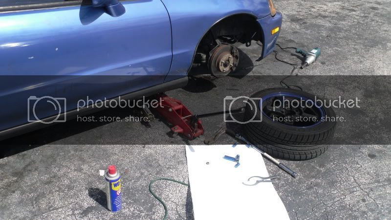

    Nice sunny day so I found something to do on the Sol. The front passenger side coilover was uneven so I adjusted it. I also tried to yank the back down about an inch, but it wont go any lower. The trunk is pretty light so I need license plate sign that says "Fat Chicks Allowed" lol. :D:

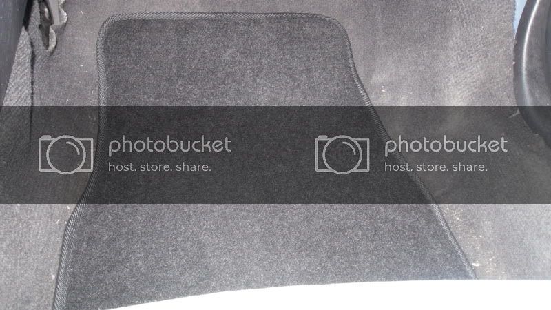

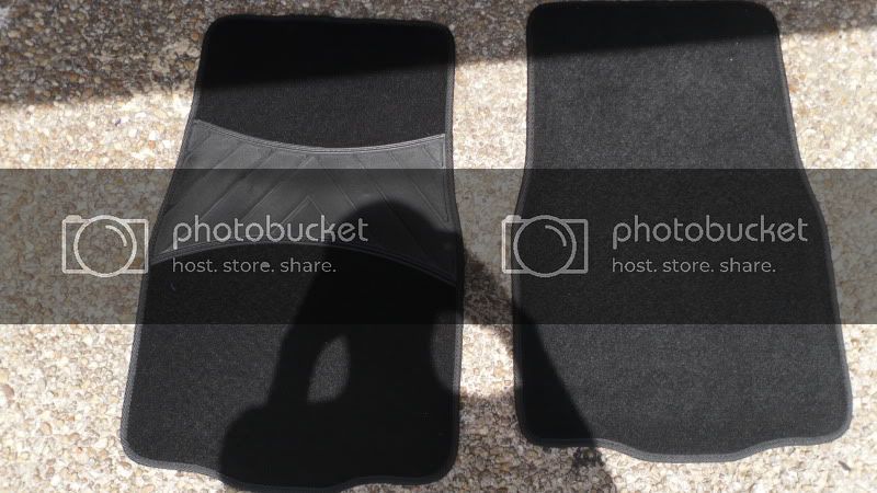

    Went to Walmart today to pick up a few things and I passed by some cheap floor mats for $9.xx. For the price it looked like it was worth it, and I can use them as a replacement for the shitty blue ones I have now because whenever it rains my foot just slips & slides on it. I also put on my FHC sticker :D:

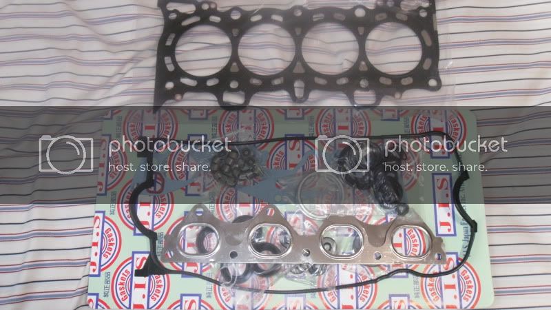

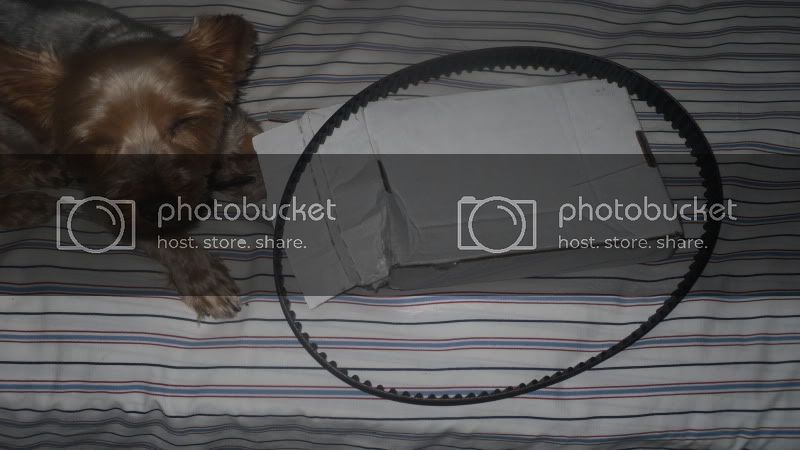

    Got my timing belt today. I'm waiting for the set of gaskets to come in the mail on Wednesday so I can start & finish this job by the weekend.
    Apr 28, 2010
    Gaskets came in the mail today :smile:

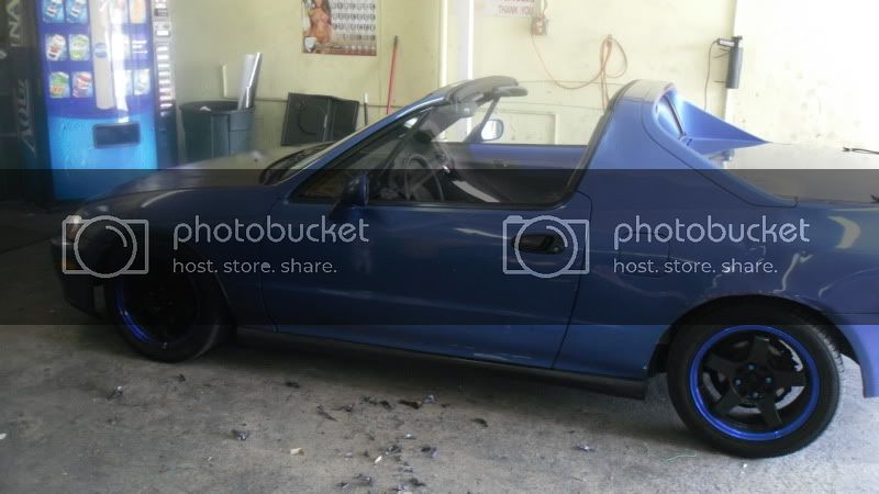

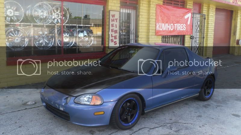

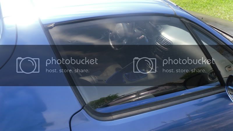

    After I got off work, I went to this place down the street to remove the tint off my windows :smile:.
    When I stepped out the car I didn't even notice that there was a del Sol right across from me. I walked over to it and took a picture since I rarely see del Sol's around often.
    It's a nice and stock Sol.
    Anyways a tintless Sol is sexayy! :D:

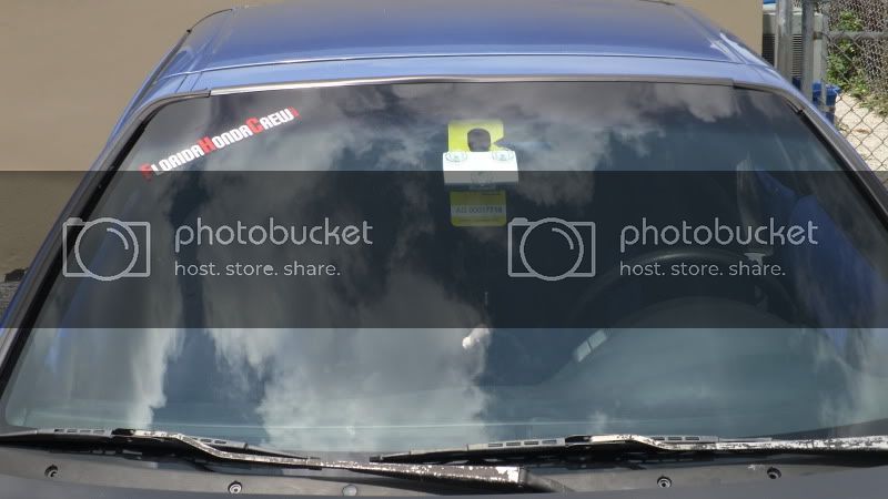

    Also I was sitting in the car and noticed this reflecting off the windshield onto the seat :smile:

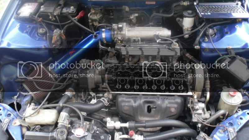

    May 1, 2010

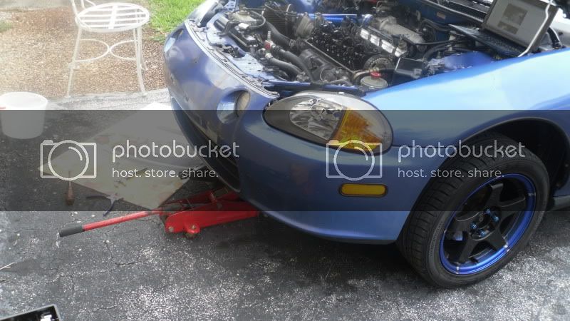

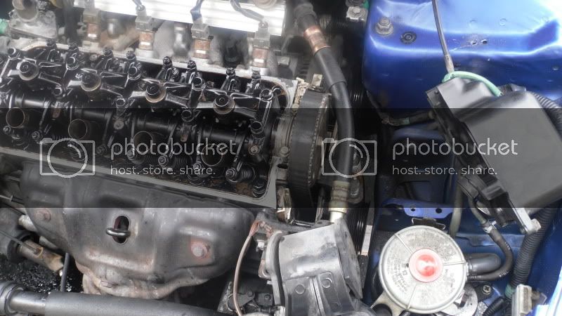

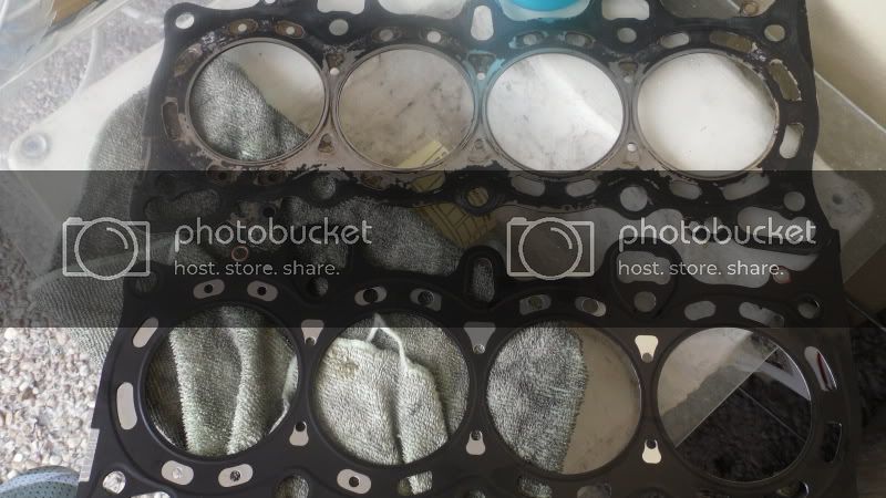

    Replaced the gasket today. Fairly easy but a long process. Didn't take much pics since my hands were real dirty and greasy.
    May 2, 2010

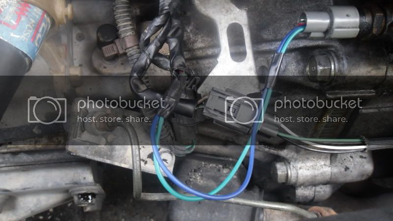

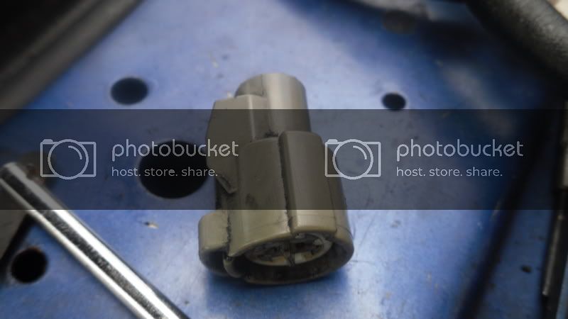

    So after changing my headgasket yesterday I encountered some problems today :scared:
    My car would idle rough and struggle to stay alive and I got a CEL.

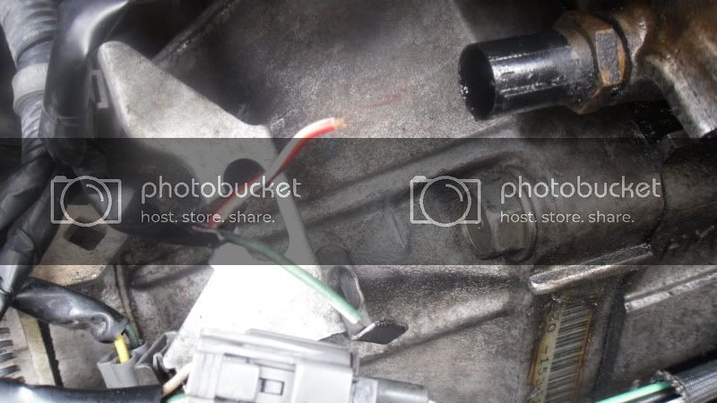

    I jumped the ECU connector with a wire and turned the car to the ON position and the CEL flashed 1 time for 1/2 second which turned out to be the O2 sensor #1.
    Well I checked the Exhaust Manifold and the O2 sensor was plugged in and connected right. So I started searching around the engine and I found this plug with 1 wire hanging on for its dear life (uh oh :huh2:)
    So I pulled the wires off and tried to figure how to reconnect the wires since they tore off from the base of the plug. I had to use a really small flathead to dig out the inside so I could push 2 new wires through it.
    Then I connected new wires to old wire and wala :D:

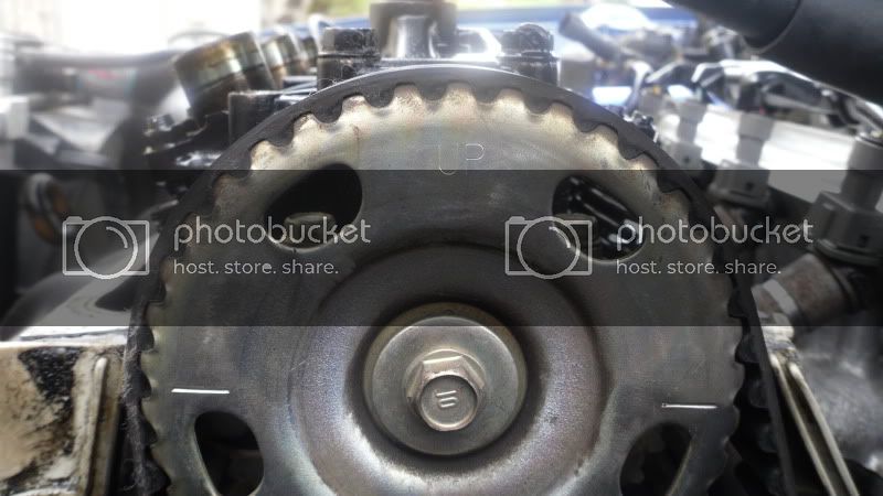

    Then I turned the car on again and the CEL was off so problem #1 was solved, but the engine was still idling rough and struggling to stay alive.
    Called a friend for some advice and he said check the timing again. So I pulled off the valve cover off again just to reveal the top part of the timing belt. Well it turns out that my timing was off by a hair so I adjusted it and car runs perfectly now.
    No bent valves FTW! :soulja:

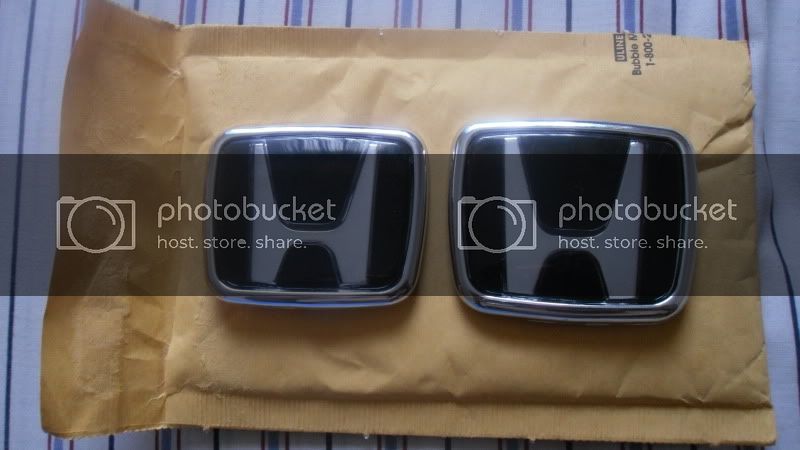

    Surprise from the mail lady :D: She dropped these off today.
    I broke off the old emblems while trying to put them back on, so I'll just throw these on there. It has the two little pins and self adhesive tape on the back so it'll stay on firmly.
