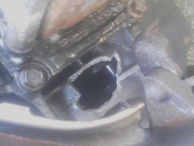

Hey everyone.. Well i'm pertty new to hondas and this will be my first ever engine swap so I expect to run into some problems. I picked up a 94 Civic DX coupe with a blown block. Body was great for a shell so i'm looking for something to drop in to get a little experience on hondas and mabye turbo up. I have some experience working on older cars with my father who is a retired mechanic. I'v been reading around for a few months on hondas and common swaps and i'd like to grab a b18c type r or mabye an H22. I hear h22 swaps arnt so easy to do but i dont mind a challenge. I just finished removing the rad AC shiftlinkage headers ect and waiting for someone with a big enough floor jack to jacker up over the engine. He should be here soon so ill try to grab some pics if my wife has the camera back. I uploaded a few pics of the shell and the hole in the block. If anyone has any comments or any little tips they would surly help as this is my first time ripping one of these engines out. Also if im correct I must remove the big nut and cotter pin on the rotor and the bolt from the control arm to pop the drive axels out? My dad told me this but like I said we have no experience on hondas. Thanks every1!

not bad but personally i would waste the money on any h serries motor go C1 and boost it but yeah youll have to take the axle nut off then jack the cap up and take the lower control arm bolt of not the upper its alot easier and if your goona go a Vtec engine i have a p28 ecu that ill sell you if youll need it just let me know

p28? Sure how much? Yeah I got the drive axels out but I snapped the control arm bolt on the passenger side so I think I need new ball joints now. No biggie there shot neways. Im waiting for my cross drilled and slotted rotors and brembo break kit to arive so I can slap them on. I;m picking up a 93 Civic Hatch Si for 300$ with 176,000km on it. It rolled over once but still runs so I might just swap the engine with mine to learn the basics before I attempt to fit a JDM engine in. The guys at honda told me it would take 8 hours to remove the engine.. It took me about 2 hours and I have everything removed and unbolted. Just need to unbolt the side engine mounts and jack the car over the engine. I am going right now to pick up the Hatch with a car dolly and might swap both engines in and out today. If I do I will try to get the camera from the wife at work so I can take detailed pictures. My camera phone just doesnt cut it.
