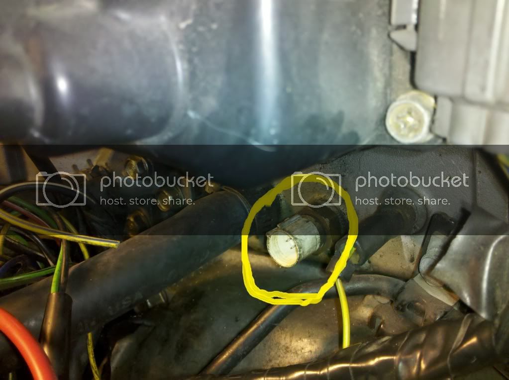

after following the wires to the ecu i found this to be my ECT

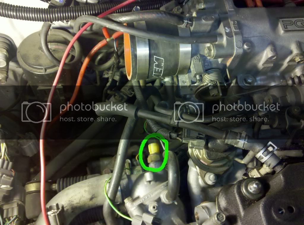

this is where my ECT should be plugged into. when i do this the CEL does not come on and the ecu does not throw any codes.

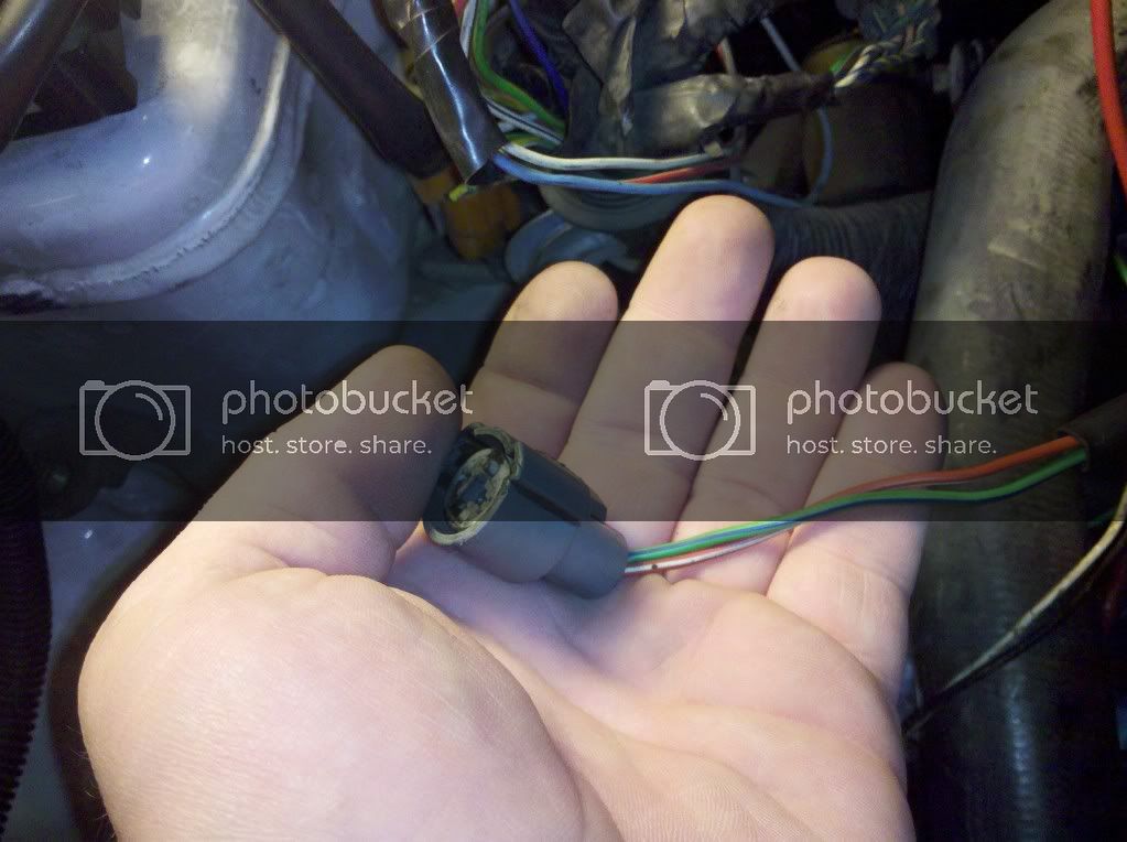

this is the set of wires that were plugged into where my ECT is supposed to be plugged. if these are not plugged into where my ECT is supposed to be the car will not run right. if i plug it back in to where the ECT goes the car runs fine but the CEL comes on again and no vtec. i followed the all green wire and the black ground. the green wire leads to the alternator control pin on the ecu. any help would be appreciated..

hey bro i have a h22 and worked on it for a while. the grey plug is for the ect. the green plug is for the vtec pressure switch. now you have to hook up your vtec pressure switch to your ecu. ecu pinout D6. if that dont work then let me know. its only one wire to the ecu. one is a ground. ground it to the thermostat.
that wire u have in your hand is the one thats on the f22 waterneck infront of the car the h22 doesent have it but the water neck from the f22 does fit. the vtec pressure switch wires are light blue and black that connector looks more like a temp sensor to me..good luck on your swap tho im havving problems with mine too
