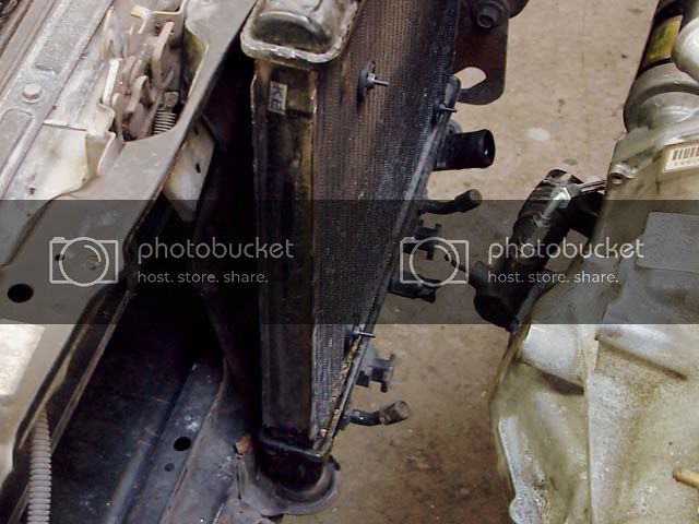

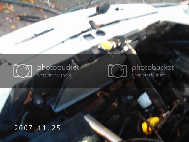

    if theres a twin core radiator in the car now you wont need to change it, just change the hose for a 99-00 si or a del sol with the b16.
    single core
    twin core
    see the difference the skinny in the first picture and the fat one in the second picture.
    hope this helps a little more.
