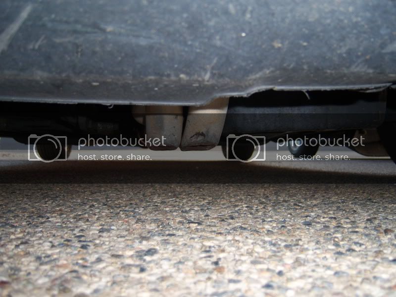

    So I put the header on last night. Before I did, I took a picture of my DC header's clearance (big ass dent and all). Getting the new catalytic converter hooked up to the exhaust today (After I drive it over to the shop.....open header). Hoping to feel a difference with the switch. The 2" vs. 2.5" plus the removal of the dent (lets see how long I can keep this one without a dent)
    FYI the Dent is from a ex-girlfriend driving my hatch when I was drinking (she effing sucked at driving over speed bumps)
    And the JDM ITR header. Before install.....I sat them right next to one another and it looked like the JDM header was about 1/4" taller (so I figure a 1/4" less clearance.
    So.....yes the stuff I read was true.....it sits pretty low. But I am optimistic in its survival on the roads with me behind the wheel.....famous last words.

  2. eg6sir
    21,692
    u need this
    fastline performance skid plate

    I do have the stock one. Just didn't put it on yet....got stainless hardware today. I did think about getting the one your posted.
    That skid plate does look like it will take more punishment. I got the stock one so It would look "normal" for mr. smog guy master fresh

    stock one?
    you mean the "heat shield"????
    yeah that flimsy sheet metal POS isnt going to protect shit from shit
    i have the fastline performance skid plate on my sol.... and i can not endorse it strongly enough... BUY ONE
    it is a very solid plate
    it works very well
    it has saved my header a few times
    :thumbsup: :thumbsup:

    Okay....hell...I just bought one for $75 shipped and taxed. Wonder if it will fit with the lower heat shield.....we'll see....doubtful. If I can't use the shield....I'll have one up for sale.

    you use the skid plate in place of the lower heat shield
    you can still use the upper heat shield with it though
