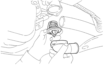

  4. Loosen the hose clamp and disconnect the lower radiator hose from the thermostat cover.
  5. Remove the thermostat cover and gasket, and pull out the thermostat.
    Remove the thermostat cover, and pull out the thermostat—2.5L engine shown

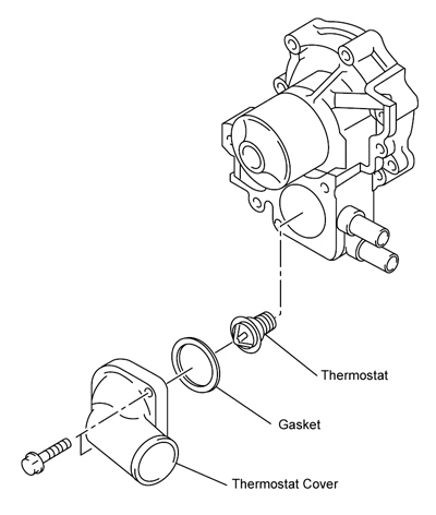

    Exploded view of the thermostat and related components—2.5L Turbo engine shown

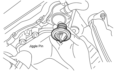

    NOTE 2.2L, 2.5L engines—The thermostat must be installed with the jiggle pin upward.
    NOTE 2.5L Turbo engines—The thermostat must be install with the jiggle pin facing front.

    Ensure the jiggle pin faces upward—2.2L and 2.5L Engines
