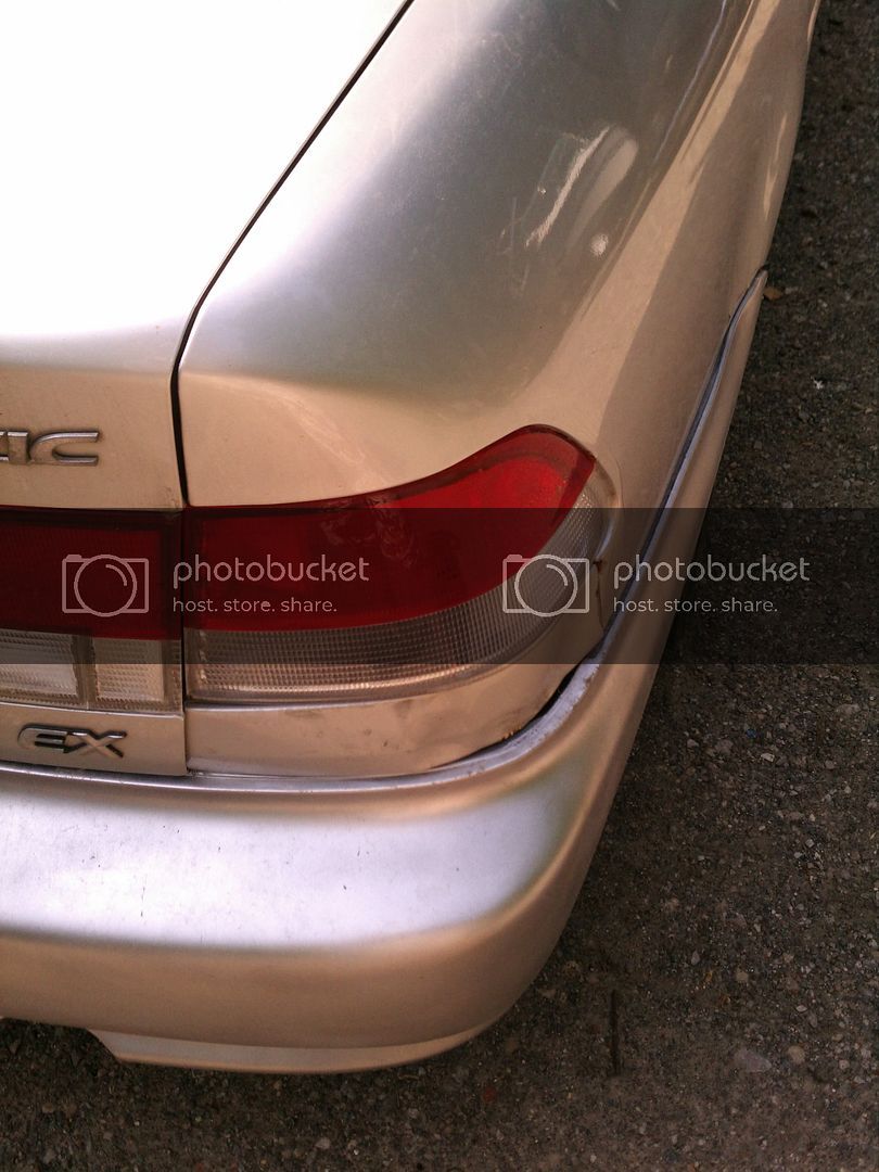

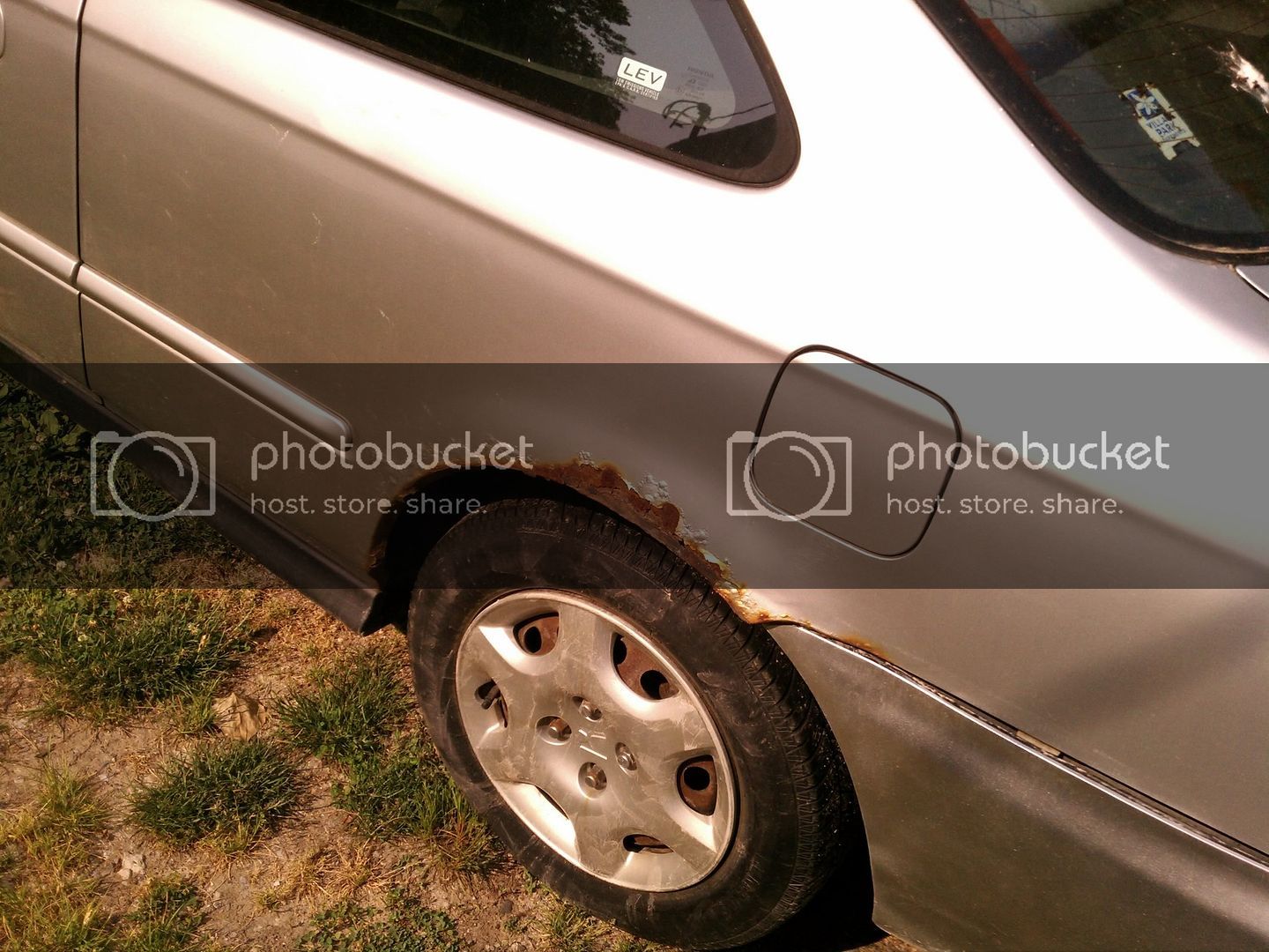

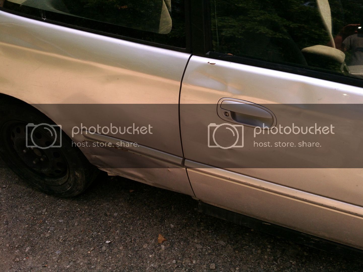

I need some advice on bodywork, the car is pretty beat up.
I've spent the last few days researching on how to properly use body filler, primer, and then paint. But I would like some Civic specific advice.
I do not think I will have to cut out the wheel arch and weld a new one in, seems like there is still a good amount of metal to work with there. I just wonder what parts I will be able to replace and which parts I will have to bang out and fill.
In my opinion you probably WILL need to cut out the fenders and replace them. That's the thing about these older Hondas, if the quarters are rusting on the exterior surface like that, then it's probably pretty rotten underneath...
