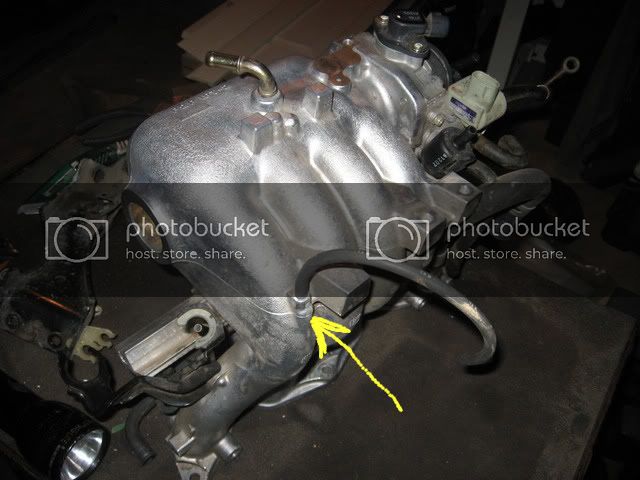

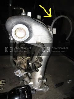

    Did a mini me swap. finally puttin the y8 intake manifold on. Havin one problem. Cant figured out where this one hose is suppose to go..or if i should just cap it off. HELP ME! and if you know where it goes...send me a pic of what the thing looks like or where it is suppose to go...someone told me a soda can lookin thing...but i didnt see nothin.

    That goes to the cruise control unit in 96-00 Civics. If your car doesn't have it or use it then cap the line off.

    ^ hes right.
    goes to ur cruise. i capped mine when i took off my cruise
