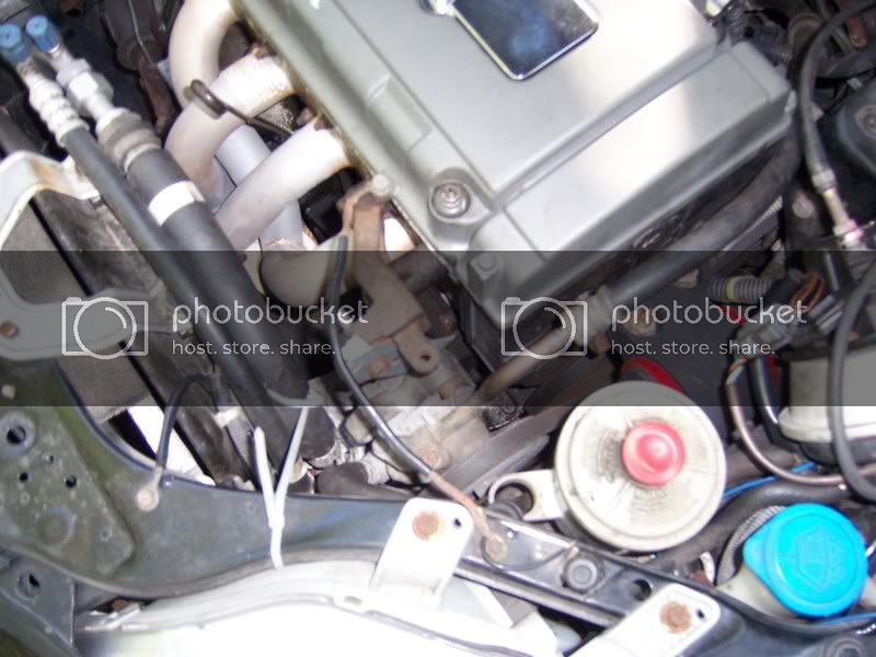

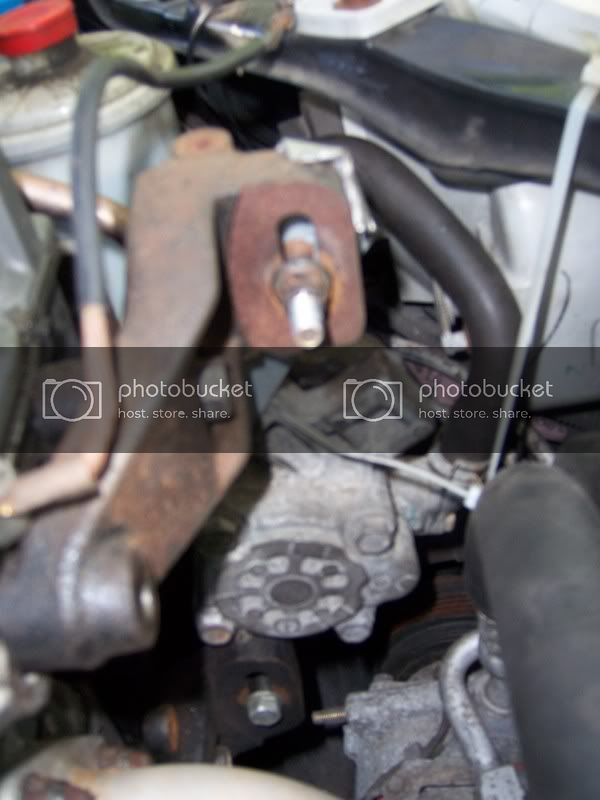

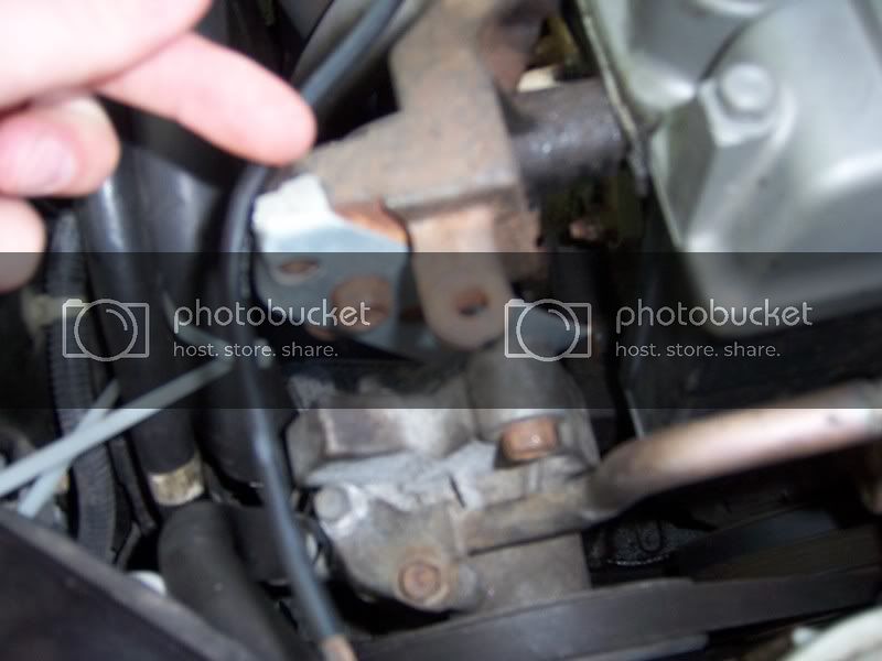

Check other posts before you make a new one, i posted in another very similar thread that you can use an ls upper and lower power steering bracket, however the upper ls bracket will only line up one bolt and you need to fab a bracket to make it fit. I will post a pic of my setup soon, it is really easy and cheap and it works great. Check this thread for info https://hondaswap.com/hybrid-eg-ek-dc/p-s-pump-replacment-b16b-engine-swap-into-ek4-1-6lt-83082/
Did you take a picture of your setup?
Sorry, i know it took a long time but i am extremely lazy. It takes some prodding to get me to do anything. Notice the ls upper bracket only uses one bolt and the clearance on the frame rail.
