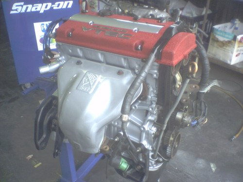

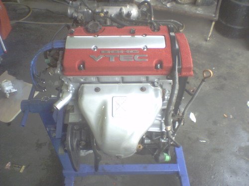

Just some piccies BTW of my H22 at the moment:
