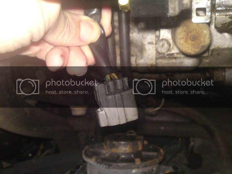

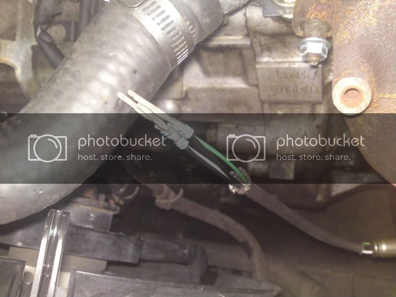

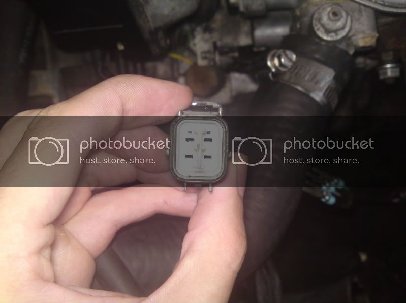

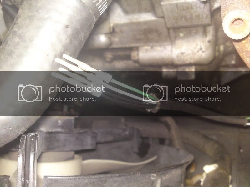

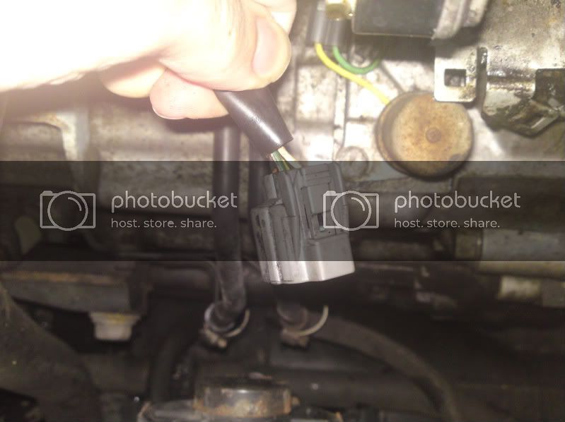

While i was undoing my exhaust manifold to fix my head gasket i knocked out the wire leads out of the O2 sensor connector harness. Its an aftermarket O2 and the wires do not match up with the engine side connector i am including some pics if they would help any.
Those look like the OEM colors: Green=signal ground, white=O2 signal, and the black wires are O2 heater.
