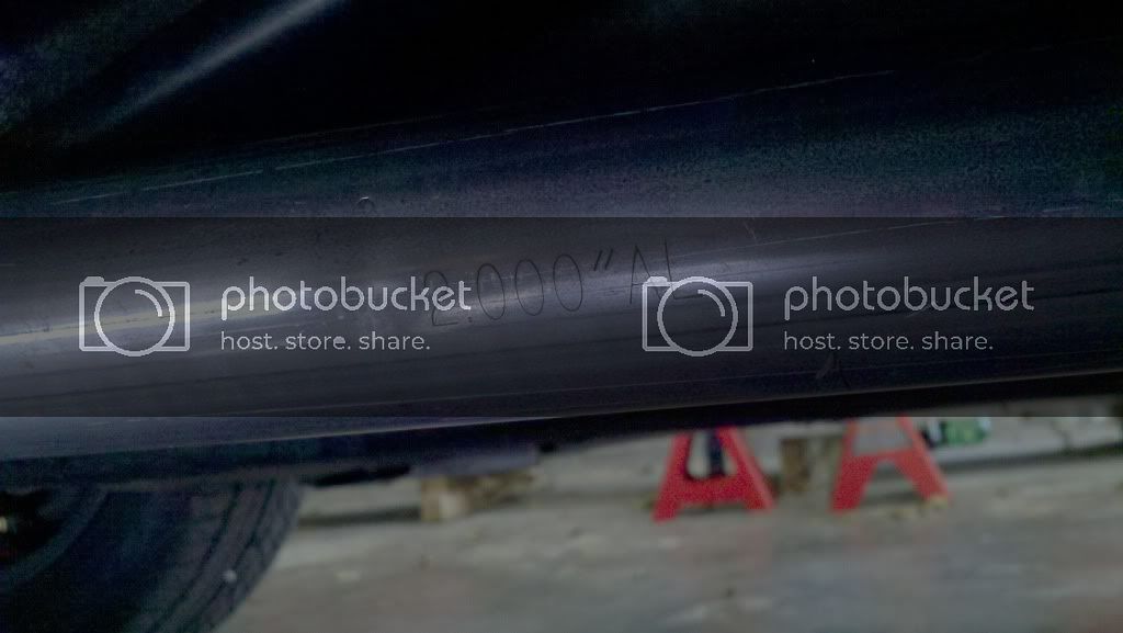

then I notice this...
They used 2.000"al piping. I called to ask why they used 2" instead of 2.5" and I am waiting to hear back.

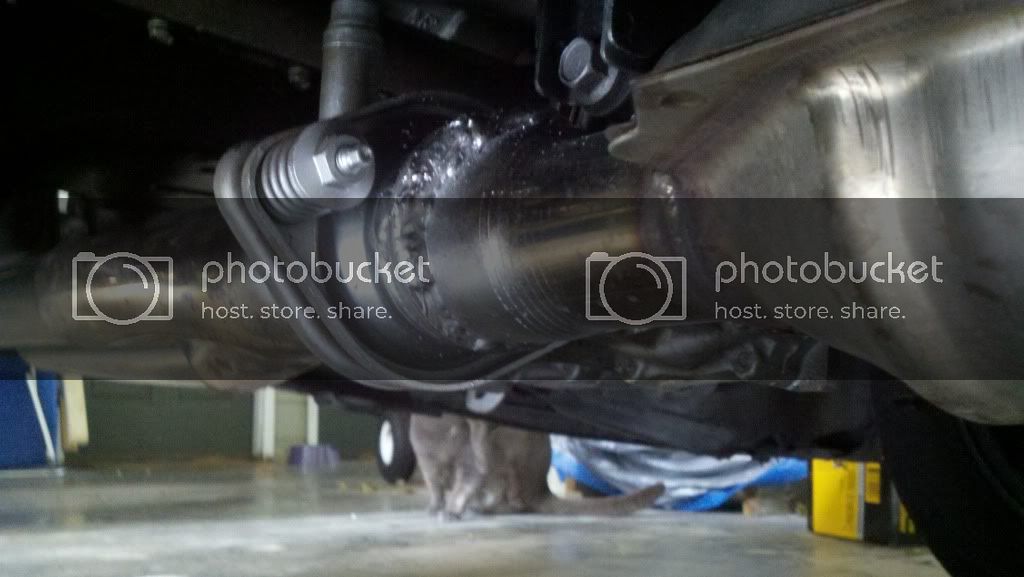

The guy at the shop is telling me that because the output of the cat is only 1.75" that having 2.5" pipe coming from the cat is basically pointless. They say that the exhaust will only flow as well as the smallest point of restriction. According to their theory having an exhaust that is larger diameter than the cat does nothing for the flow of the exhaust. I am not an expert by any means, but I am pretty sure that is wrong. What do you guys think?

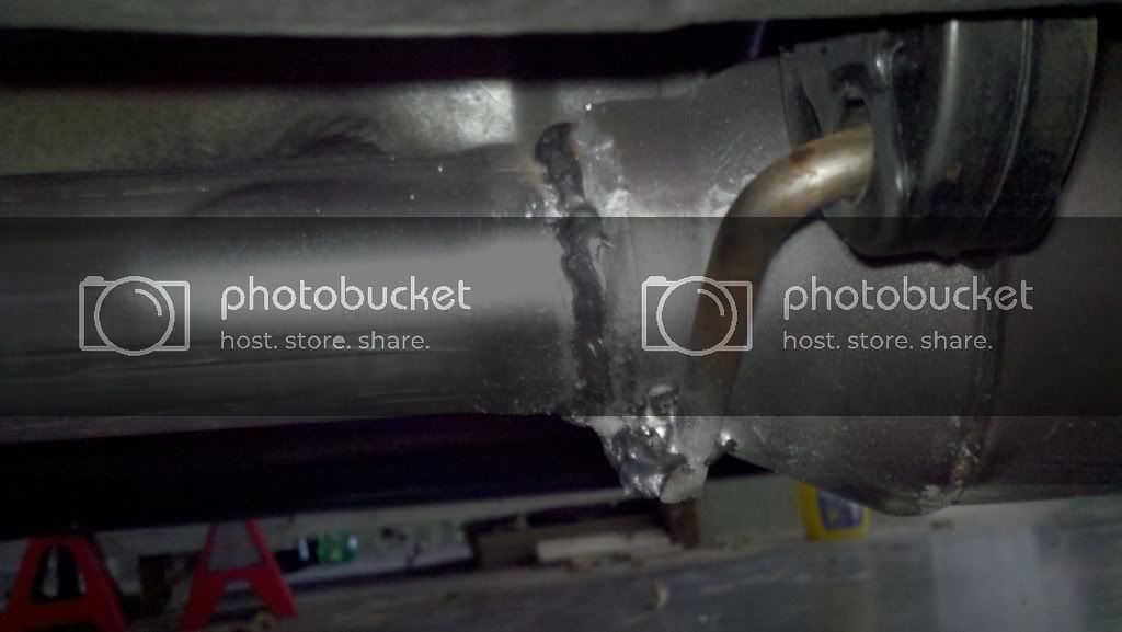

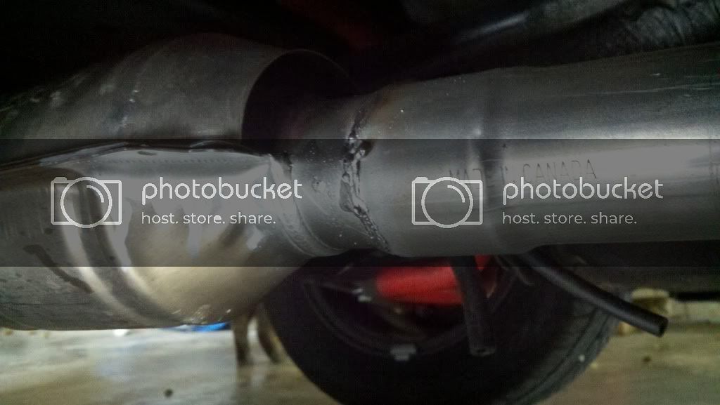

those welds looks like bubble gum anyway, id almost have them redo it on that basis alone.

and yes those welds look like shit

The price seems a bit steep and the welds aren't great but the pipe sizing theory is correct. I wouldn't put 2.5" pipe coming out of a 1.75"-2" cat...the series of adapters required to size up would look far more stupid than the 2" pipe they used and it would accomplish nothing.
With a choking restriction like a cat or small piping, the only thing larger piping accomplishes is to alter the tone of the exhaust.
Aluminized piping is not cheap and is coated, much like galvanization. What did you expect them to use? Stainless? The truly cheap exhaust tube is non-aluminized. It rusts immediately.

As for the welds they are not great, but they are not bad all around. Just mainly there at the hanger and the break.
