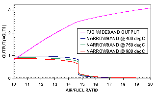

odd... the 02 doesn't send out anywhere NEAR 5 volts.
on a narrowband (oem honda) 02, it is a slim range just under 1 volt
