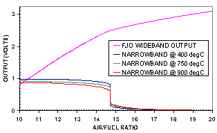

anyway, as far as wideband- its like this
as you can see, the narrow band (or normal) o2 gets about the same reading... from rich, to stoich, to lean.... its all withing .0x voltages, and something that simply can't be read accurately with a device.
the wideband uses a wider voltage span, to show lean, stoich, and rich conditions based on a voltage- how 99% of other sensors work.
