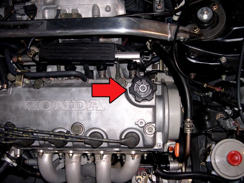

It's a really shitty picture, and I made it smaller for ya'll screen. But anyway, ya they're for coolant lines like I said.
The large one is for the coolant bypass hose. The small one goes to your throttle body's fast idle thermo valve (FITV).
capishe?
well take that previous post in, and let me know if you think you'll have an idle problem :)

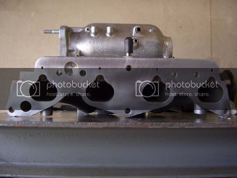

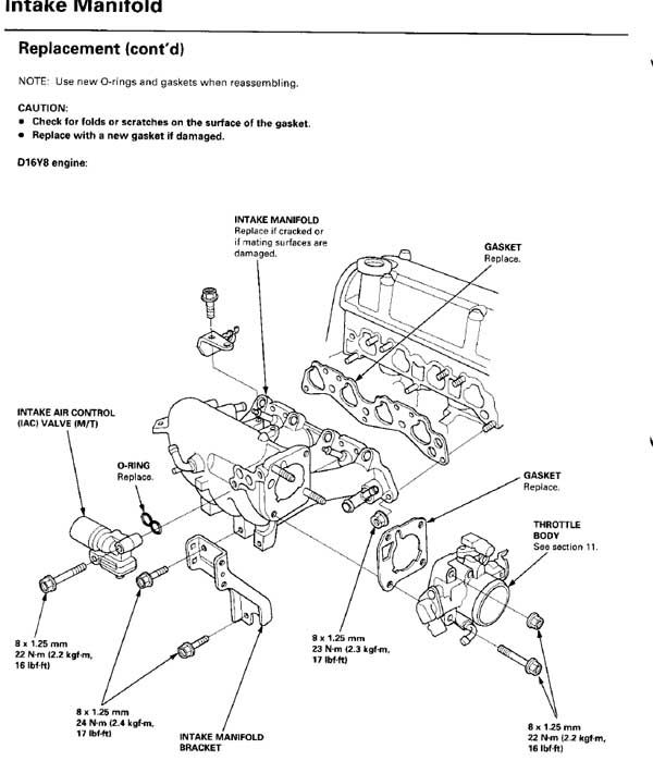

well the manual had the information scattered, and i just thought this might help you see as well.
YOU SEE THOSE CIRCULAR HOLES ABOVE THE INTAKE PORTS? whoa..caps lock.
anyway that is the air injection holes also called the FUEL INJECTION AIR
sweet ya. fuel injection air is what it's called. now i gotcha. the honda manual covers that for 2 whole pages and never otherwise mentions it's existance (even in the cooling chapter, because the valve is actuated by engine coolant temperature).
Well since the ECU doesn't control the operation of the FIA valve, that doesn't matter.
What does matter however, is the fact that the FIA valve mounts in the thermostat housing. So since your going to swap in a Y8 block, you'll have that valve in there.
May as well route the lines to it (one air line to the intake arm, the other to the intake manifold).

Heres one without it
I think it actually plugs to the intake arm looking at these 2 pics, but i really cannot tell.

z6: Ahhhhhhh. and yes, it goes into the intake arm.
When i get home a lil later i'll post up the 2 pages my honda manual has on that system, just for the sake of information. Then you can decide if you should use it or not, based on it's function, as I have judged, but I guess you don't understand, because like I said already, the FIA is NOT ecu controlled...
