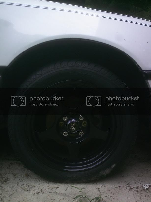

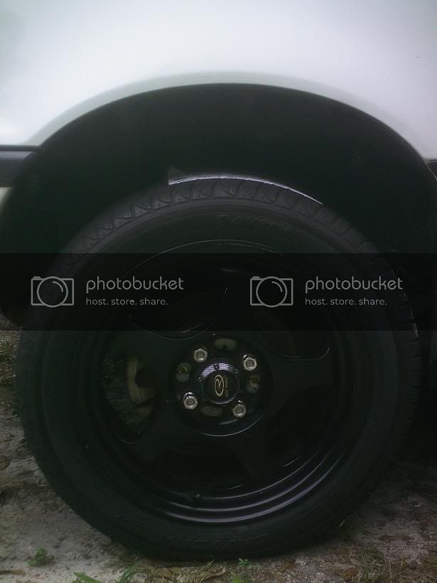

Threw two of my wheels on there last night just for kicks. Need springs much?? lol
(just fyi, i'm going with Omni-power 'street' adj. coilovers)
thats the actual gap. no jacks/stands. thats how it's sitting.
